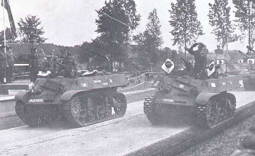

Well found this photo of pair of Stuart V, but without their turrets. It clearly backs up the colour profiles in the pdf link in my first post.
regards,
Jack
