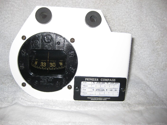

Gina,
I have reporduced the compass bracket. I have a set of original windshields. if you need any photos let me know.
Steve

Are yours Aluminium or steel. The ones I once owned but were swiped were steel , My Friends is Aluminium. Also my friend has a rather complicated pressing to hold the glass in, my originals steel ones never did. I am wondering whether my original set was locally fabricated during the war.

My original compass bracket was brass. I have also seen aluminum brackets. I had them made out of aluminum. My windshields frames are steel. I have seen a couple other windshield frames that were steel as well.
