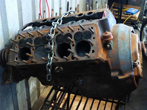

Ok lads here she is or shall i say was will post more pictures on how she looks now.
Any help i can get would be great Cheers Shane

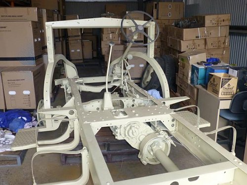

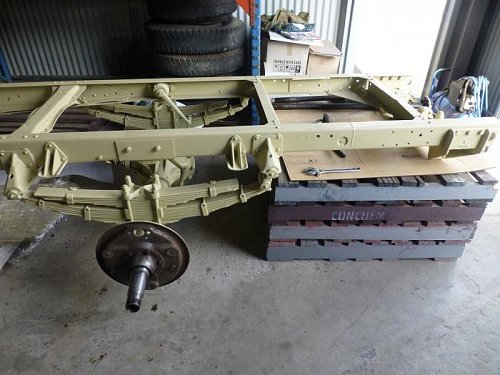

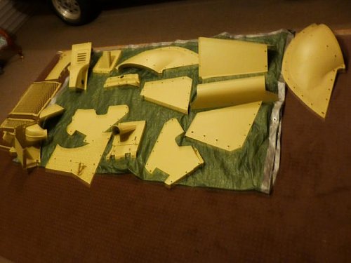

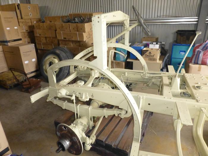

Well at the moment fuel tanks are getting done as is the motor, I am leaving a few dings in the panels here and there as that is look i want. I would like the look as it was when used by the Australian army not as it came off the line. Help from you all would be great thanks to all so far. Will post more photos soon.Cheers Shane
F60L Cab 12
Old 06-06-13, 15:09
Default Progress
You're really steaming ahead on this Shane, most impressive!

Nice work Shane, she'll look quite striking in Portland Stone. Interesting chassis extension, they've used the entire rear section off another chassis.

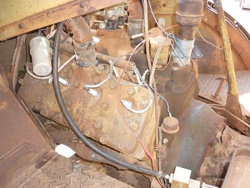

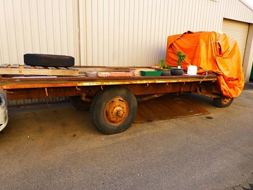

Here are some more pictures. The motor did run before we took her apart the other truck in the photo is growing the veg very well, hahahaha a green blitz and a shot of the cab 12 in bits. Thanks for the photos Andrew do you know what happened to the jeep?
F60L Cab 12

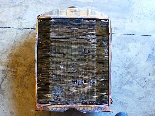

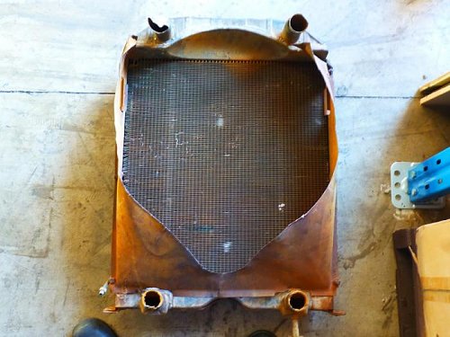

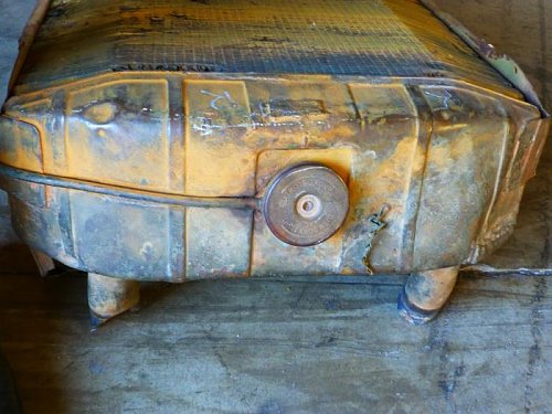

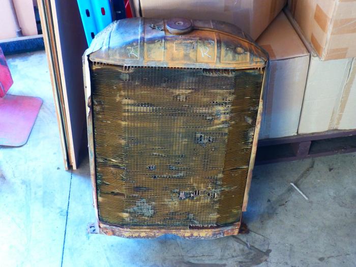

Had a quote to fix the old girl and wait for it...............$2000. Is there a modern radiator i could put in for a while? I want her to run well so i dont mind using something modern under the hood. Cheers Shane
F60L Cab 12
Old 07-06-13, 21:46
Join Date: Mar 2013
Location: NORTH WEST UK
Posts: 256
$2000 to sort that out??? That's about 1,500 in real money (UK) bit steep that my friend. I would shop around. I've had bigger rads rebuilt on CAT 320s for less and they are 6 core! No back yard repairers near you? Send it to bloody India n would still be cheaper!!!! Lol

Hi Shane - I have a radiator that was restored by Balhannah Radiators. $900 and it is yours.

Hi Bob. $900 sounds better than $2000. However i know a bloke that is doing some electrical work at your place could you give the radiator to him. Come to think of it make it $600 and there wont be any fires caused by electrical fault bwhahahaha (this could happen if i bribe him with a CHEV blitz truck)and you know as well as i do he couldnt say no. And now your asking yourself how does he know who is working at my place...........scary, so scary that maybe i should make it a fair deal and put in a fuel cap(im missing one) and repair the dash for this young man. Its all in your hands now Bob. Cheers Shane

Hi Shane - I had another look at your radiator and saw that it was a tropical core one with the chamfers on each edge. The one I have is out of a Cab 13 Ford so I do not know whether that would be suitable. We need to know whether yours is the typical radiator for a Cab 12.
Ford F15 - unrestored
Ford F15A X 2 - unrestored

I have no idea if its a typical radiator for a Cab 12 . Ill ask Keith :teach By the way does anyone know who does cushions for the seats and also webbing to go between the body panels. Cheers Shane

Hi Bob
As far as I know they are all interchangeable, the CMP ones have taps at the bottom and the lower outlets are in line with the water pumps (unlike Carrier radiators for example). Yours looks like a CMP one. The Cab 13 radiator should fit although the sheet metal shrouds are different.

I think the 13 radiators are slightly different
I have fitted 2 different radiators from 13 cabs to my 12, but the lower hoses don't line up with the water pumps. They can be made to fit, but not without a lot of swearing.
The shroud is also different allowing for a cross bar to be inserted through the upper part of the shroud.

Would it work if i use flexi pipe? Thanks for all the feed back lads its good of you to give your time. Thanks Shane.
But the relative positions of the radiator mounts to the water pumps was unchanged between cab 12 and 13. It's not uncommon to see cab 12s and 13s retrofitted with truck or carrier radiators where they don't line up. I've had to fit the wrong ones myself sometimes and if you fit the hoses first then push the radiator down into position before tightening the clamps they work OK.
