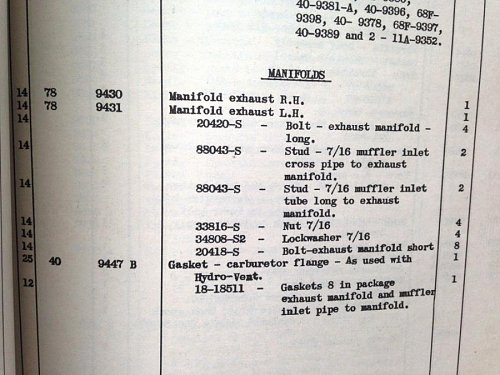

Hanno, the 9430 is the Ford base number for an exhaust manifold (one side or the other) the other is 9431. To get your particular type of manifold you need the prefix like: 8CM -9430 and this may be followed by a suffix for example "-B" etc.

Lynn,
Thanks, of course: just checked the parts list and it's number is 78-9430 for the right hand side exhaust manifold, the one I need.
