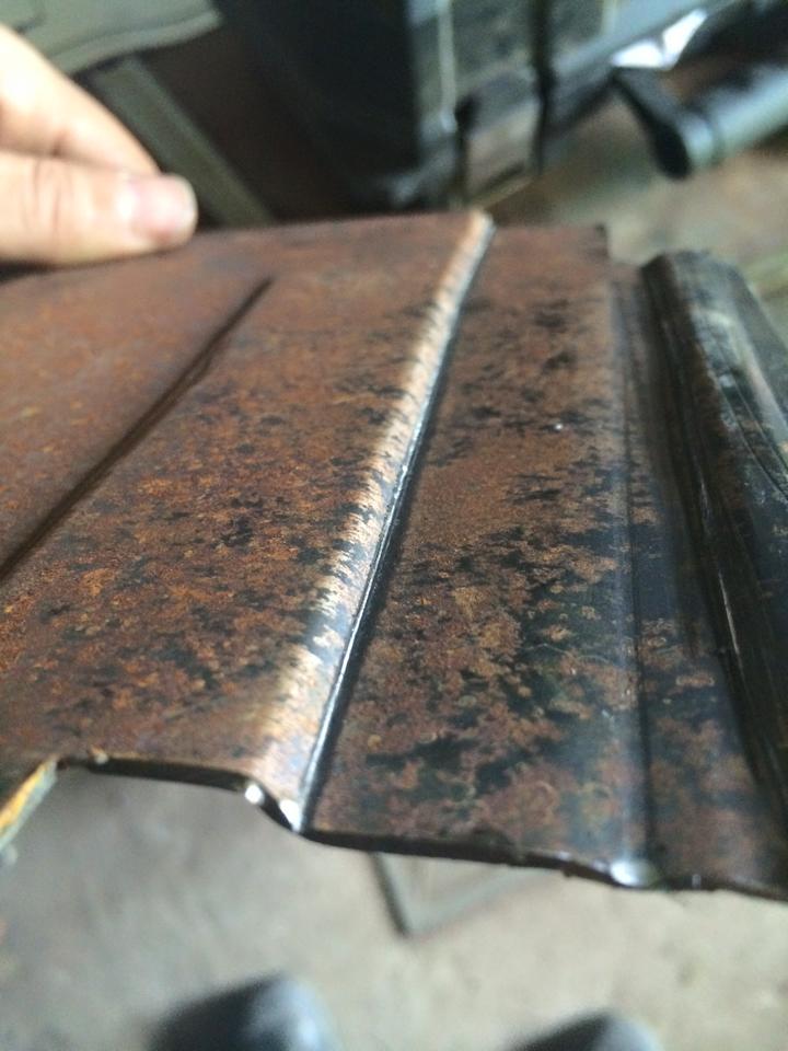

Hi Stuart
Bob, that works for me made his own bead roller and it works great. The one photo shows where we were playing with stiffening panels and the other photo shows a try at the top detail on a 13 cab door skin.
Barry
