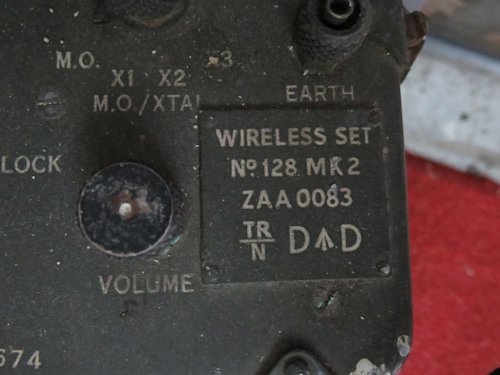

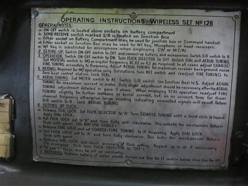

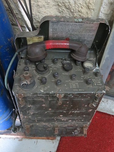

This is a wireless set No. 128, what cam you tell me about this one?
Once again I know nothing about this one.

I had one of these . Designed late WW2 but not issued until after the war. Used in Korea .
These sets are a total nightmare to work on, you have to disassemble the whole set to gain access to the circuit components . There is a control box that clips onto a belt . A throat mic or the handset . It is a HF set , not VHF.
A ham friend of mine used one and we had a good AM QSO on the 80 meter band when I was in Tasmania and he in Melbourne .
The TR/N would be TASMA RADIO NSW
