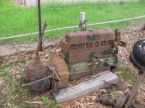

Welcome to MLU Matt. The Bedford was mine, I obtained it from a farmer just up the road from me and passed it on to Tony L. who sold it to Richmond G. The farmer used it for a general farm truck until there was a malfunction of some sort and then they towed it around the paddocks with a tractor for carting hay. The tray which was on it was not the original but was on it when they first acquired it.
Tony L. cut a lot of rust out of the chassis, hopefully not where the chassis no. should be, but I can't remember. The Cabin also required a lot of repairs but Tony was right up his street with that.
As you know, I still have the engine here and if you haven't picked it up before July, I may be able to bring it to Adelaide. That depends on my health which is not the best at the moment.
Name:	OY Bedford engine 001.jpg
Had a look at the engine number today it is:- OY73076
Regards Rick.
