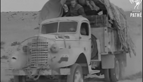

Default GMC ACKWX-353 in use with the British Army
Originally Posted by David_Hayward (RIP) View Post
Earliest S/M Demands
S/M 2007: WHITE MODEL 922 EX-FRENCH
S/M 2008: GMC ACK-353 EX-FRENCH
S/M 2009: GMC ACKWX-353 EX-FRENCH
S/M 2010: GMC ACK-504 EX-FRENCH
S/M 2011: CHEVROLET YR HOULDER THORNTON 6 X 4 EX-FRENCH
S/M 2012: DODGE T-203B EX-FRENCH
S/M 2013: ?
S/M 2014: WHITE 760/MACK EXBX EX-FRENCH
S/M 2015: ?
S/M 2016: GMC AFWX-354 6 X 4 EX-FRENCH & CHEVROLET C15
S/M 2017: DODGE T-214-L EX-FRENCH
S/M 2018: FWD
S/M 2019: FORD & CHEVROLET
S/M 2020: CHEVROLET C-GT & FORD F-GT
S/M 2013 and 2015 could have been Mid-East deliveries but I have no evidence yet as to what they were...
Some footage of the North Africa shows an ex-French contract GMC ACKWX-353 in use with the British Army.
Source: https://youtu.be/Zmc7u9Es6Xg
