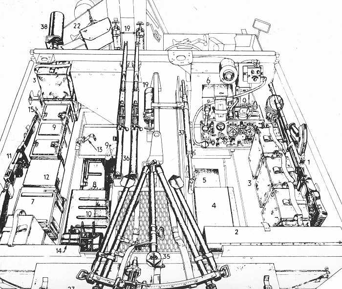

Have a look at this stowage diagram. I cannot recall from where it was taken.
I am still looking for the pix of the Falk Carrier with radio.
Stewart

I mounted my 19 set in my Mark ll carrier in the position shown in the Stowage Diagram for the No.2, Mk ll, wich as described earlier being behind the division plate directly behind the driver. There is photo of this mounting in Bill Greg's Profile book as well as a drawing. You will notice on your carrier a bracked near the division plate up against the armour side wall and also on the fold down seat which was used to clamp down the 19 set. If you require a copy of the stowage diagram please contact me via the forum message board.
Gord Falk

Darrell, here is the stowage for a Mk.II* Carrier showing the 19 set installation. (this is always confusing as what's pictured here is what most people call a "Mk.II". It is actually a Mk.II*. A true Mk.II is really a mortar carrier and resembles a Mk.I* with all the mounting holes filled in with rivets and stowage for the 3" mortar and bombs).
I can help out with some of the parts you are missing if this is the installation you want to do.

To confirm, Darrell's 19 set is a Mk.III Canadian one. The Carrier appears to be a Mk.1*, but I'd want to check the holes in the armour Stew identified. If they are open or filled with nuts and bolts (i.e. there was originally something mounted there), it's a Mk.1*. If the holes have been factory filled with rivets, it is a Mk.II (not Mk.II*) that was originally a mortar carrier.

Thanx for coming out Mike, your advice and info was most helpful. Right after you left, Jim Rolfe showed up and we had another nice visit and talk. He showed me pics of the work he's done on his Willys (very ), added some info on ours (still for trade!!), and also relayed his UC engine experiences. This was all most helpful and we thank him too.
My radio is definately a Mk III as that's what is on the tags, the carrier is a Mk I according the #'s and I'll post the exact ser# that Mike pointed out, a little later today.
The smoke bomb thrower mount holes on the right are bolt-filled as are the folding antenna mount holes at the right rear side. I'm off to look in here (on Mikes suggestion) for our own folding antenna. Also in regard to the Bren Question, guess I need another mount, x2 poles and of course the Brens. It also looks as if there wasa box of some sort mounted on the rear vertical plate but now is just a rectangle of holes.
Later
Darrell

Hi
The # on the top of the Driver's armour plate is CT 112851. If this means something signifigant to someone, please let me know.
regards
Darrell
