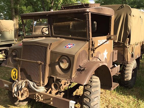

What about this 'Get me home somehow' photo?
A well prepared Ford here, and NO the hitch is for towing home not pushing.
