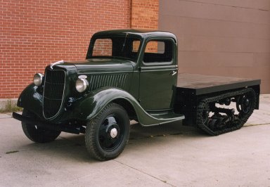

Thanks to all for input and suggestions.
Went on CWM website. Came up with this.
Part of their collection..
Not much info..but they call it a Model 51 Innes-Cunningham/Ford.
Never heard of I.C.
Were they a competitor to MH..?
Said to be a pioneering Canadian Artillery Tractor.
According to Museum..Tested by RCA..PPCLI and Queens Own Cameron Highlanders of Canada.
I wonder if this is the same truck from the auction..?
At the same time …given it's recorded use by the Artillery…still a possibility it was part of the Shilo trials.

Difficult to say for sure with grainy photographs but I'm starting to think yes.
