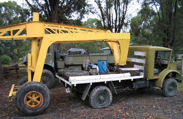

It may well be a post-war conversion. However, it is interesting to note the CGT winch fairlead and cab floor, and there wouldn't be too many of these cranes made onto CGT cab/chassis except for those wartime "Aust No9" chassis examples.
Also of interest is the variations seen with single ram/dual rams, and the design of the pivot mount ( "C" section beams or "lattice" style). Peters Bros made these styles of cranes for a variety of vehicles and SWL ratings. There was no single design model. Add to the fact that they were made over a couple of decades, I think you would have to have a Peters Bros catalogue or sales brochure to definitively date or classify any particular example. I'm sure that some over the years have even been moved from vehicle to vehicle, and even modifed by users to suit specific applications.
Other companies, such as Servex, also manufactured similar cranes during the war and after, and may share similar appearances.
Despite that, if this crane was closer, I'd like to have a good look at it (for the chassis No. of the CGT and a builder's plate on the crane), and perhaps if it was closer still, I'd be buying it!

Yes definatley lots of variations and probable refittments from tracktors to trucks etc along with additional manufacturers. My theory with the CGT is that more of these would be used post war mainly due to the CGT specs making them ideal for conversion. Particularly the shortness of wheel base.
Its a shame the seller hasn't posted more pics of those plates etc but Im sure the information would be available if some one closer could/would chase it up.
They are a unique vehicle to drive and make you constantly think which way you have to turn the wheel to make the crane do what you want. I have driven Laurie Winney's one a couple of times and its definately interesting

Laurie's is a perfect example. It is a wartime built crane, and quite different to the known pictures. However, it is the 3 ton W9 model for an International Harvester tractor, that has been fitted to a Blitz post-war by an unknown modifier. The wartime pictures are of a 5 ton crane. It demonstrates that different crane models do display different features for different weight ratings even in the same time period.
