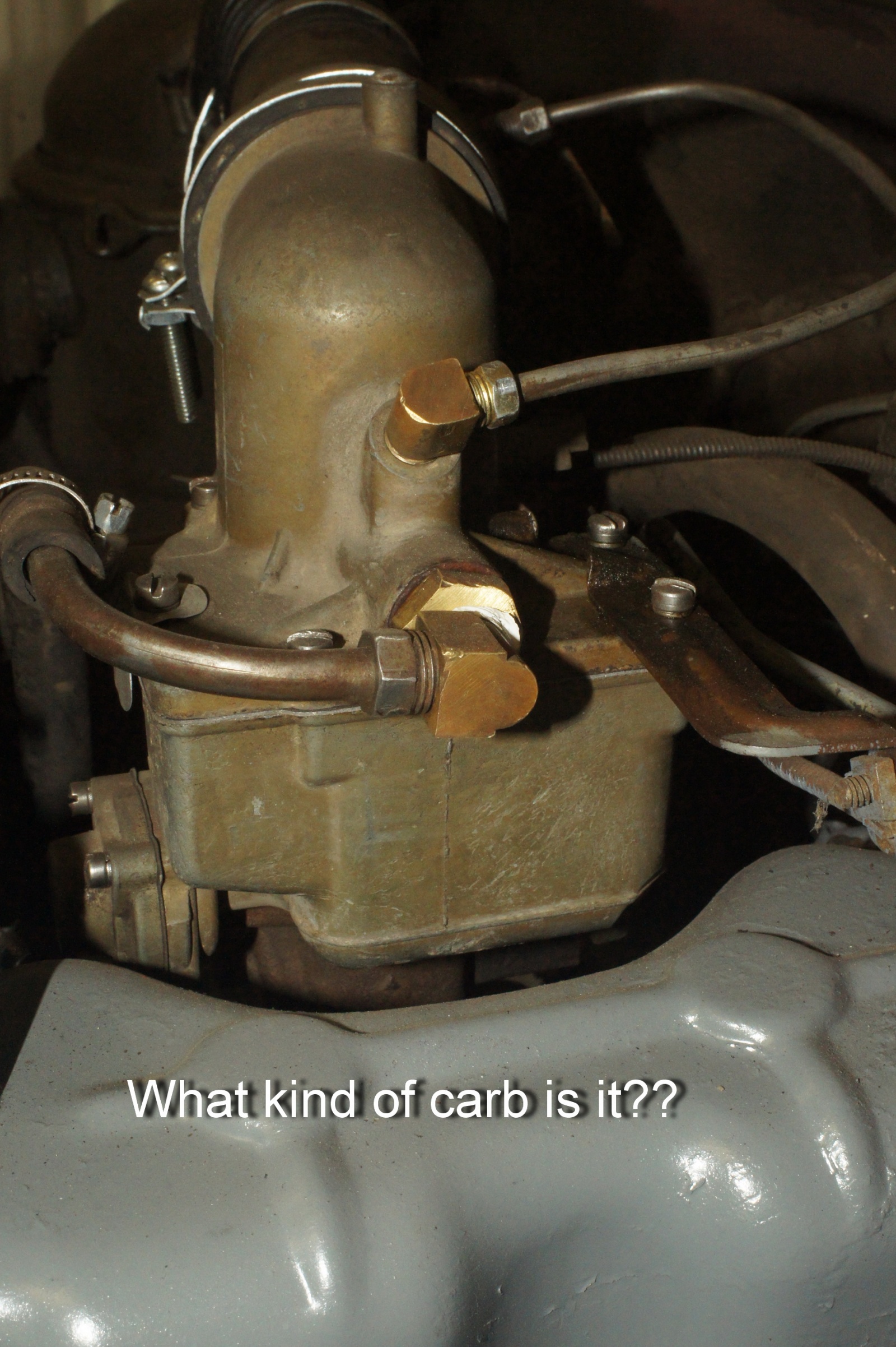

Default Here comes the pictures and questions.....
will need to do in two postings.
aaDSC07169passsideresizededittext.jpg   bbDSC07170edit.jpg   ccDSC07173edit.jpg   cDSC07172edit.jpg   dDSC07176edit.jpg
Old 09-06-18, 06:22
Default Part two......
Would appreciate comments on the ID tag...
...........thanks for all your help guys.
Next Wednesday we operate!!!!!
lastDSC07167edit.jpg   hDSC07161edit.jpg   gDSC07183edit.jpg   fDSC07179deit.jpg   eDSC07178edit.jpg

Default Carb
The carb is a Carter YS950S; standard fitting for the M38A1.
Owen.
