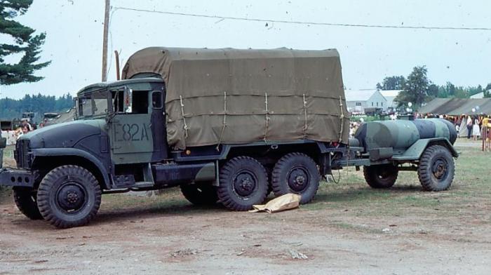

Here is my quandry. I have borrowed some user uploaded pics of various vehicles from this Forum and "Google" to set the plot:
Which Color Green is 503-319 Field Green?
This one:
MLVW as it sits today:
M151A2:
McEwan M38A1:
Clives M38A1:
Or this one:
Iltis:
Cougar:
Photo induced color variations aside, am I the only one that notices that the 503-319 Field Green is not the same over the years of the 3 Color Cam Pattern? Did it change at some point or did it actually fade that much over the years?
The Field Green on the MLVW I posted on top is what all of the remaining 3 Color Cam Vehicles have for Field Green here in Gagetown, yet there is clearly a darker version on other vehicles.
When people are trying to color match paint for the 3 Color Cam Pattern, which shade are they trying to replicate? Top or Bottom?
Thoughts???

On the NOS Iltis body tub the 503-321 was the base coat. The darkest Green on the picture posted. I would call this is an Olive Green but not the same colour as the old Olive Drab used in WWII.
The Lighter Green (Pea Green as it has been called) on the Iltis is 503- 322.
No question about that as I matched it to the one Iltis that I have that still has the orginal paint on it.
I wet sanded a portion of this lighter green to remove the oxidized-faded paint and it is an exact match for the 503-322 colour chip.
503-322 has a tendancy to fade to a bluer green.
The darker green (olive) on the MLVW, M38A1's the Cougar and the M151 would be the 503-321 The lighter on the MLVW M38A1's and M151 green would be badly faded 503-319.
On the Cougar the lighter green is 503-319 but not faded.
503-319 is a near exact match for FS34094
FS34094 is the current 383 CARC colour. And we know how much it fades and lightens up. It fades up to the light Feild Green 503-322 and lighter. We have numerous examples of this happening.

According to the colour chips I have FS34079 is much to gray for 503-319.
The best match seems to be the 383 green (FS34094)
It seems that 304-322 was used on the Iltis's original from factory paint as the lighter green.
Other than that use it is anybody's guess where else it was used. But it likely would have been part of the camo scheme to better match units with faded paint that needed touch up's or was just wholly substituted for 503-319 as seems to be the case on some vehicles with fresher paint jobs as they are way to light to have been painted with 503-319.
503-322 is not a sea foam but a true green the posted pictures can be deceiving and it looks a little more blue in the pictures than it actually is. There are 11 different Sea Foam greens listed in the 1-GP -12C colour specs so sorting out a specific Sea Foam would be pretty hard unless you had the colour chips in hand to match it and most all of them had Gloss Semi Gloss and Flat finishes.

I have found somewhere on the web a photo of a deuce and a half with a water trailer. The trailer looks like it has a pea green in it similar to the camouflage green that i have in my can. I know this does not help the question, is it pea green or is it faded. (This photo is from Ed Storey's vast collection, thanks).
Regardless this is an interesting discussion.
thanks
Eric
