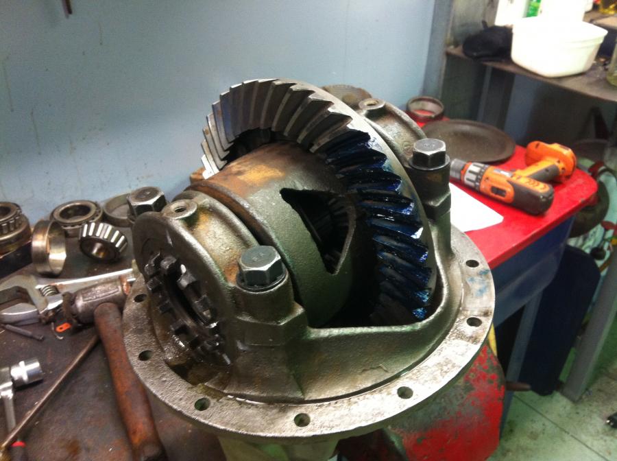

both front and rear diffs stripped and rebuilt, new shackle pins, bushes, brakes, bearings, seals etc.
because this is an early 41 model ambo it has the smaller diff. so to speed the old girl up a bit i purchased 2 complete half ton dodge diffs from jim harris and have fitted the 4.89 gearing into the back diff.
currently doing the front. has all gone together well so far. thanks to robin mawson for his time in showing me how to do it all.
I think 4.89 is the standard diff ratio in 1/2 tonners . Bevan Fenner fitted 4.1 ratio diffs in his 1/2 ton dodge ,( he sold the truck to Graeme Kerslake , then it went to QLD ? ) maybe you could ask Bevan where he sourced the 4.1's from ? Mike

i beleive the 4.1 diffs that bevan used came out of a post war dodge delivery van. from memory he said it would do about 70mph. which would be hair raising to say the least on a truck chassis i would imagine.
hopefully the 4.8's with the bigger 251 engine should move it along ok though.

The WC54 (3/4 ton) originally had 5.83:1 diffs.
I believe a few 1/2 ton Dodges were built with 4.89:1 diffs (ambulance?), but most were still 5.83:1.
(I have a couple of 4.89's in storage) I did have a 3/4 ton dodge on 7.50x16s on 1/2 ton wheels with 4.3:1 diffs. Yes it would run up to about 70 (guess) but ran out of legs in low gear on a steep hill.

Your absolutely correct with the axle ratio's. Many years ago, a friend of mine changed his 3/4 ton carryall ratios to 1/2 Ton spec axle ratio's, and it was a real b*tch to drive !, slightest incline and you were changing down, and you had to use 1st gear to pull away. My 3/4 ton Dodge retains it's factory spec ratios , and will sit happily at 45-50 mph all day, and still pull like a train up any incline, even leaving Series 3 Landy's behind.

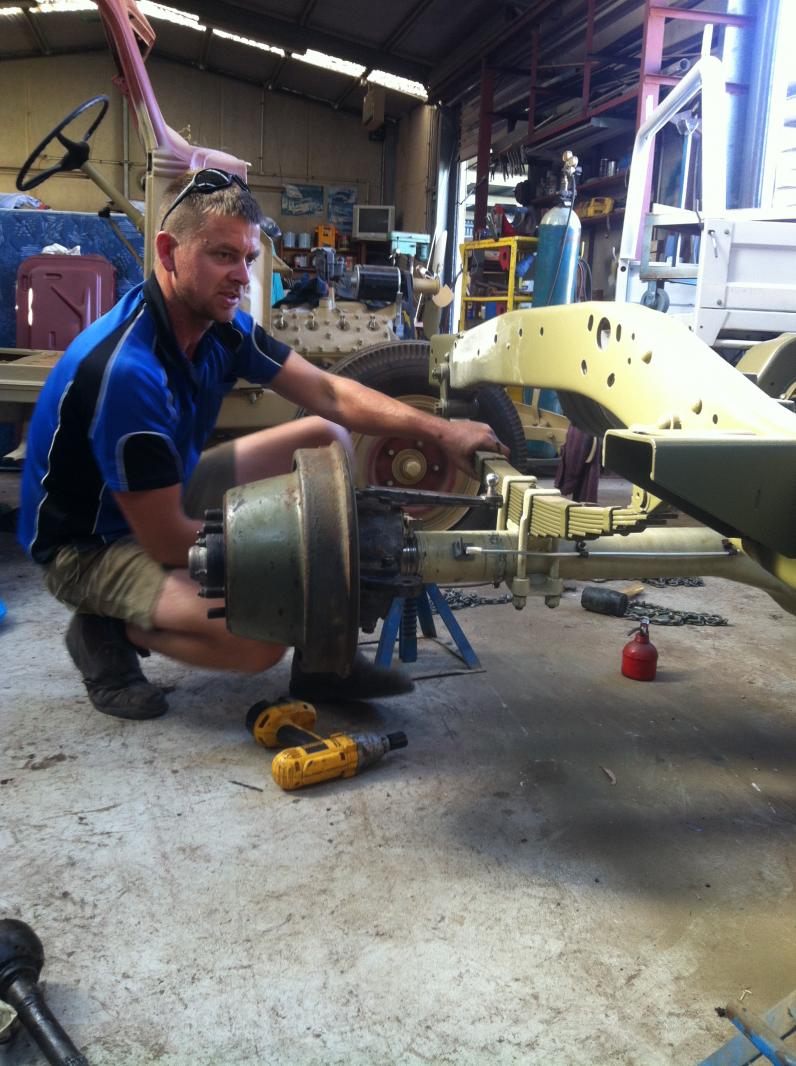

finished overhauling the front axle this weekend. new brakes, bearings and seals. bit of mucking around to swap the diff centres over. The axle splines are different between the 1/2 and 3/4 ton dodges, i had to pull the crown wheel and pinion out of the 1/2 ton diff and set them up on the 3/4 ton case to take the bigger axles. the rear axle was easy as you can just install the whole pumpkin and use the 1/2 ton axles aswell. it all went together nicely after that. installed it this afternoon and will give it a lick of paint next weekend.

finished painting the front axle on the weekend. fitted the new wheels and tyres. pulled apart the shock absorbers. all still had fluid in them and were in very good condition. refilled with oil and bolted them on.
the 2 pintle hooks i had were pretty buggered and had a lot of slop in them. i pulled the two apart and with some new pins/ spring and some welding and grinding managed to put one good one together. nice and tight now.
