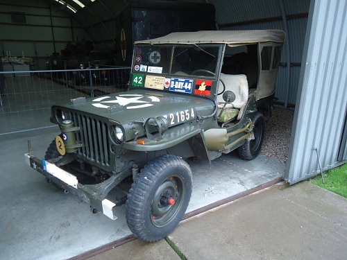

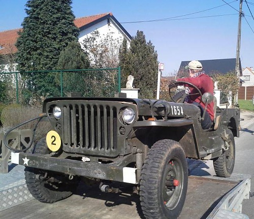

Meanwhile two pictures of what we're starting with...
09th January 2016
http://s153.photobucket.com/user/joh...n16-1.jpg.html
http://s153.photobucket.com/user/joh...n16-2.jpg.html

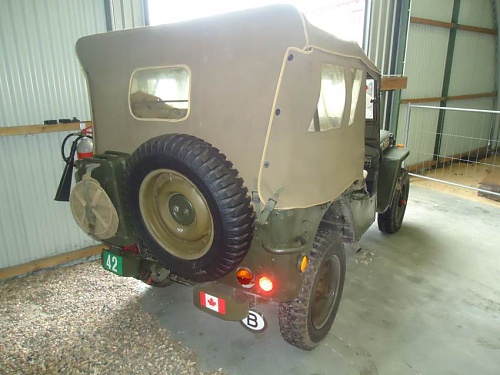

Update on the restoration... GPW has been completely restored from the frame up...
Still need to finish some electrical details, windshield and then markings...
Quite a difference in three months (27th February and 14th June 2016)...
http://s153.photobucket.com/user/joh...6%203.jpg.html
http://s153.photobucket.com/user/joh...6%202.jpg.html

Jeep is now finished and awaiting markings for the 3rd Division...
Can someone give me some RAL codes for the French Grey field and Golden yellow Maple Leaf markings??? Thanks
http://s153.photobucket.com/user/joh...Aug16.jpg.html

Thanks Hanno, will go with the 5 then...
Meanwhile unit markings have been applied...
http://s153.photobucket.com/user/joh...Sep16.jpg.html

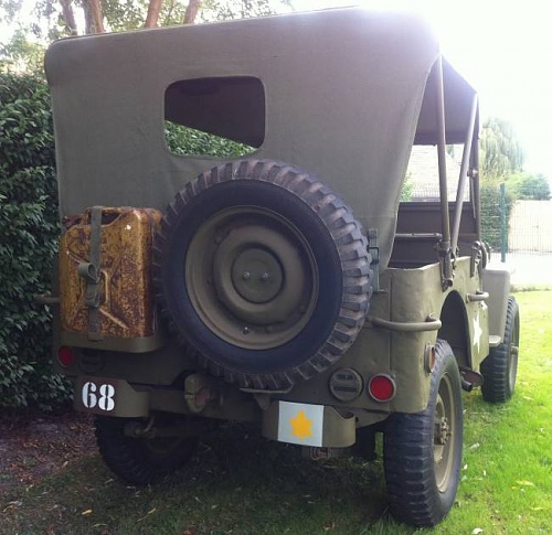

Hello my friend. Nice restoration . I see the 3 rd Division tactical sign. What does the 68 stand for please ? Thanks.
44 U.C. No-2 MKII* /
94 LSVW / 84 Iltis
Old 11-09-16, 15:50
Posts: 1,742
Default Google 101
Type in 'tactical sign 68 3rd canadian division' and voila....
http://www.canadiansoldiers.com/vehi...lemarkings.htm
magically appears.
Old 11-09-16, 15:58
Posts: 4,192
Ive always found this site great for looking up vehicle markings.
http://home.cogeco.ca/~gdavidson1/home.html
