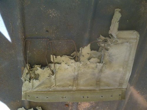

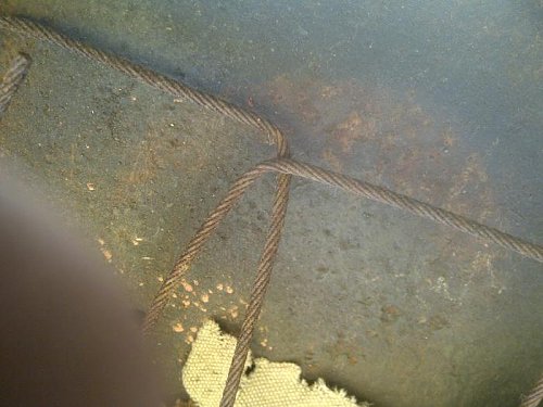

Does anybody know of a source for the kind of twisted(?) wire that gives the spring to canvas mudflaps? Does anybody even know what that kind of wire is called?

Default 20CWT trailer
Harry.....what vehicle are the flaps from....?
The ones in the pictures are off of my 20CWT trailer, but they look to be the same as the scraps left on 3 or 4 front fenders of my CMP's. same width, material and folds and stitching at least for the top 2 inches that survived under the metal strip that covered them on the inside of the fender.

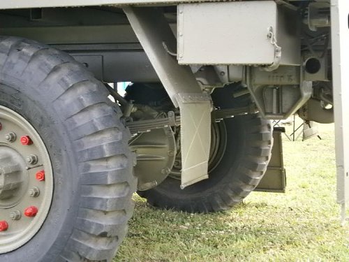

Name:	Mudflap design.jpg
Up until this thread, I was intending to only put a flat aluminium bar across top & bottom inside the canvas cover, as per the above photo I took at Canungra 2011.
Attachment 50701 Attachment 50702
Hi Harry..
This is just a round spring steel basic wire ..comes n a roll and it is formed as you like..
Sanvik make tons of it ..Check this out here..
Once you know what to call it it is easy to find..
http://www.smt.sandvik.com/en/produc...s/spring-wire/

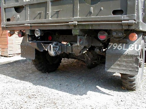

Old 14-10-18, 10:17
Posts: 14,935
I have seen the mudflaps in canvas with metal strip insert sewn inside, as well as all canvas with metal strips rivetted to the outside. Both were lacking this wire rope framework.
My 1943 F15A has the latter type mud-flaps. Didn’t know these are originals.
