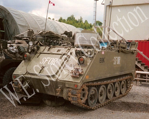

Hi Guys im looking to see if anyone has any information on the m806 arvl
like how many pounds the winch can pull and and fluid capacity or any info would be great. there were only a few in Canadian service and info is basically not available for these units.

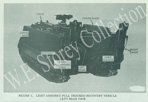

First I ever heard of M806 ARVLs in Canada. The M113A2 Recovery vehicle, light, was still referred to under the M113A2 name.
I just checked our tech library, and we have the parts manuals for the ARVLs.
I note the winch parts are the same as that used on the M577 ARV. I'll research a bit further. I'm pretty sure I saw the data summary here somewhere, but my tech library is a collection from several sources, and a lot of things like data summaries were not put away by their respective CFTO numbers.

Found the data summary for the ARVL. It is a Pacific Car and Foundry model P30 (modified) 20,000 pound hydraulic winch.

I called it a m806 as thats about the only carrier that I can find any information about and seems to have only been used by Australia and Canada. These seem to be a rare beast and there is virtually no information or really any photos of them in Canadian use. 20000Lbs seems like a really low powered winch when your thinking about pulling forces on a stuck carrier in a bog even once double lined.

Don't mix rolling resistance with the weight of the vehicle being pulled. The ARVL was meant to give units with M113s the ability to recover them. A carrier is only 21,000 pounds, give or take, and depending on conditions, the winch is only dealing with a fraction of that. So once you go to 2 to 1, or even 3 to 1 on the cable setup, you have plenty of pull.
The majority of the NSNs in the manual for the ARV are US based, so the design may well be adapted from some American variant like the M809.
Is there any specific information you need on them?

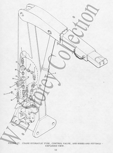

Is there any information about fluid capasity of the hydraulics and pump info or the plumbing in general
