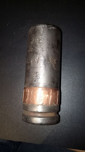

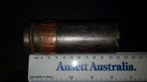

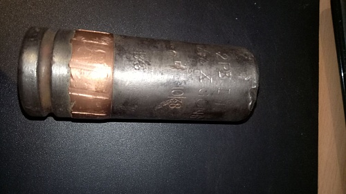

I know that this is something from a 2pdr gun, but what is it?
It is 4 inches or 102mm long, close to 1.5 inches or 38mm wide but with a FLAT top.
The markings are quite clear and it is marked P 2Pr I.T., Mks. IX & X guns. further on it has RL 65 and the date 10/38. Below all that is BS.
ID:	107781 Click image for larger version
ID:	107783 Click image for larger version
There are some ordnance marks HH with /I\ above it, QL /I\, /I\ , and JD with /I\ below it.
Why is it flat topped?
Over to you experts.
Thanks Rick.

It is a practice flat shot. Flat topped to limit range and ricochet.
Anti tank guns had a practice flat shot for range practice, usually with a reduced load.
These are often called a proof shot today but that is incorrect as a proof shot has no tracer and is fired with an overcharge to proof the gun.
The markings indicate 2 pounder Mk 1 (shot) with tracer (T)
For Mk IX and X guns which were the anti tank guns, rather than the pom pom type.
RL likely Royal Laboratories.
10/38 is the date.
BS indicates it is turned from bar stock
