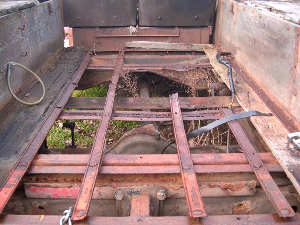

Hello all,
I am Danny Croone from the netherlands and new to the forum. Reason why i joined? Some 40 years ago my grandfather took apart a Canadian Dodge APT together with a US WC-51. Now we are left with a big puzzle
Hope to find some info on the APT, especially for identifying all the parts i find.
For that i require a (digital) partslist, already sent a PM to Grant Bowker but maybe somebody else can provide one?
The engine that is on the truck does not belong there, it is a T214 (likely from the US WC-51). The original T236 is present but in parts. No ID plate in the cabin as the glovebox door is not there (well, not found it yet) but there is a norwegian army plate inside the cabin. The framenumber is 91168137.
When the truck is "collected" together it will likely be sold. My grandfather is in his 80's and i do not have time to restore it, a shame.
I am sure i will folow up this post with questions....

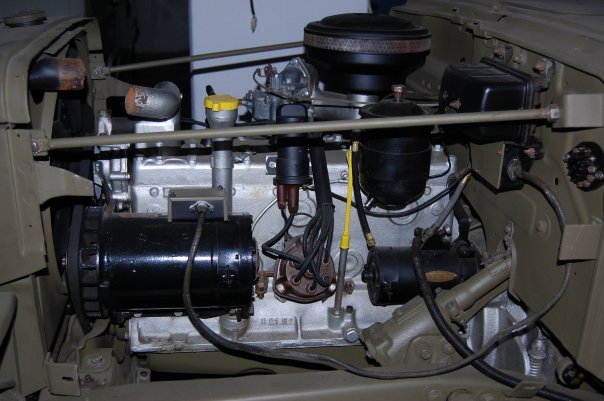

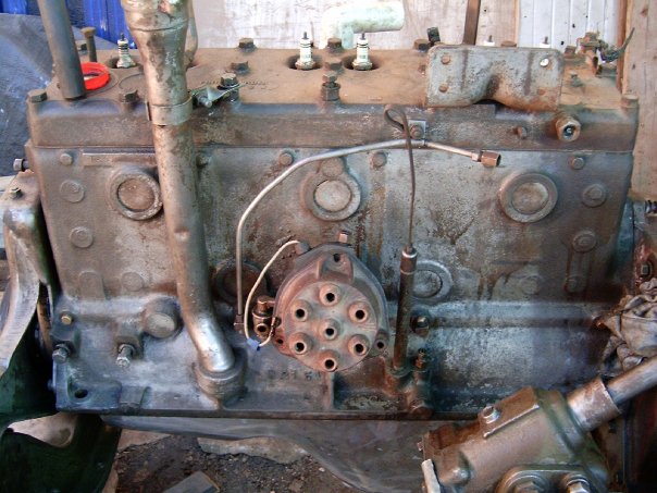

Hi Danny
the correct distributor cap for yor dodge is the one attached to this post
Rob

Hello Rob,
Thank you for that excelent photo, i found a few different distributors and one of them is like this one.
Case closed
I do not see many photo's online regarding details of engine etc.
Are you doing a restauration? Looks like it
More photos like this are very appreciated!

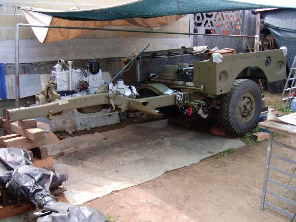

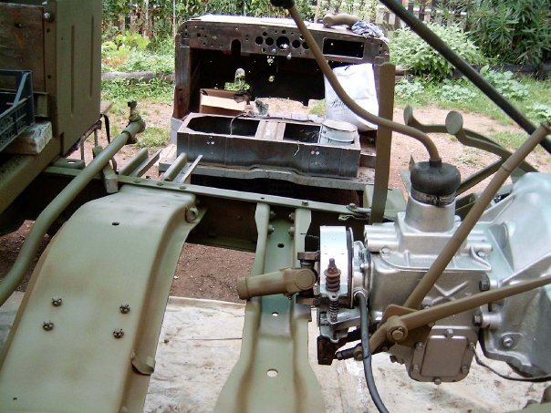

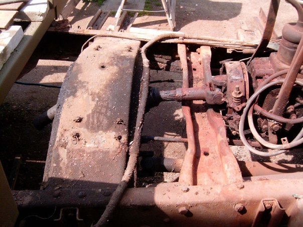

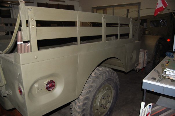

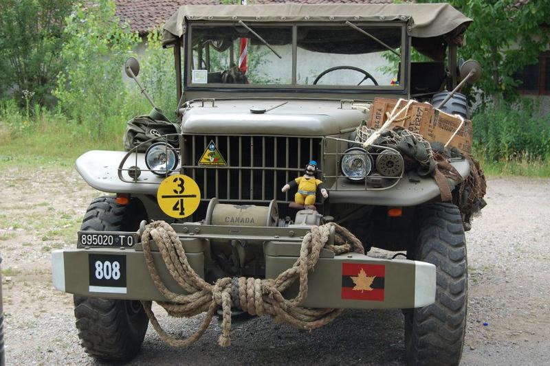

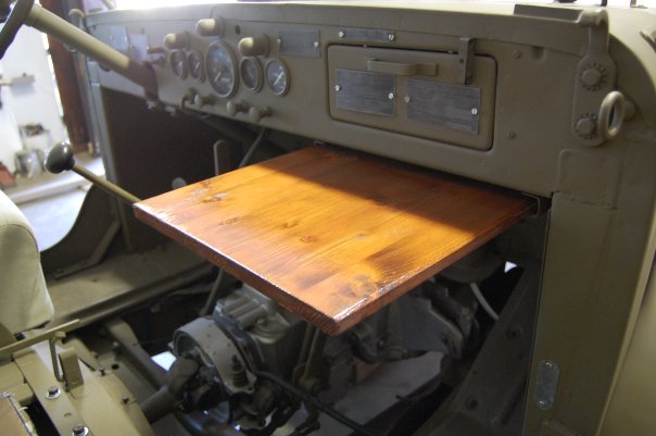

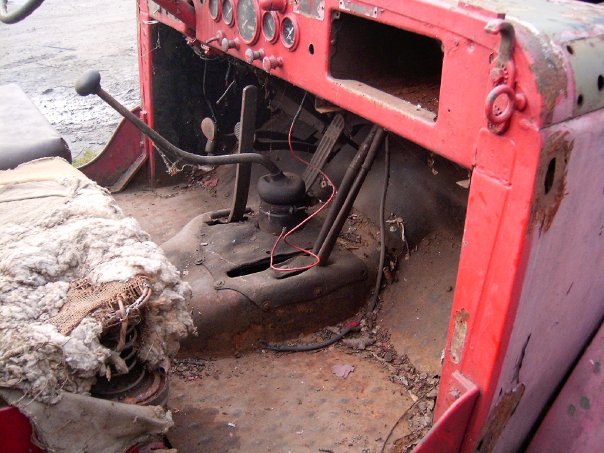

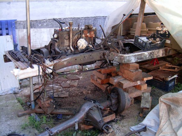

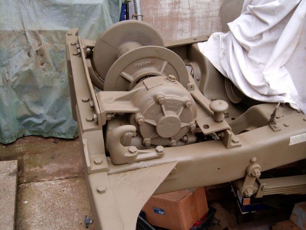

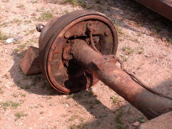

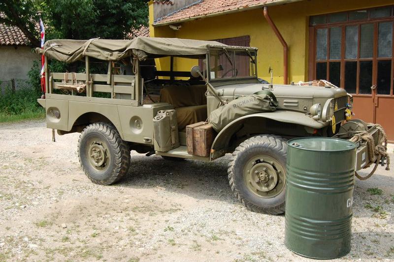

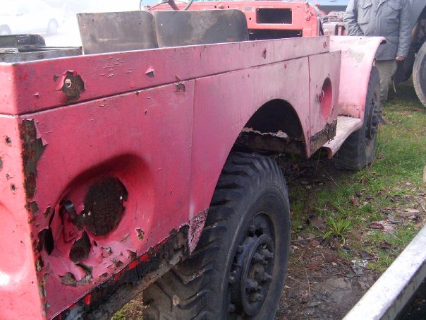

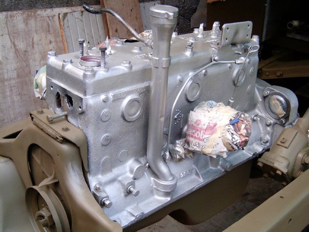

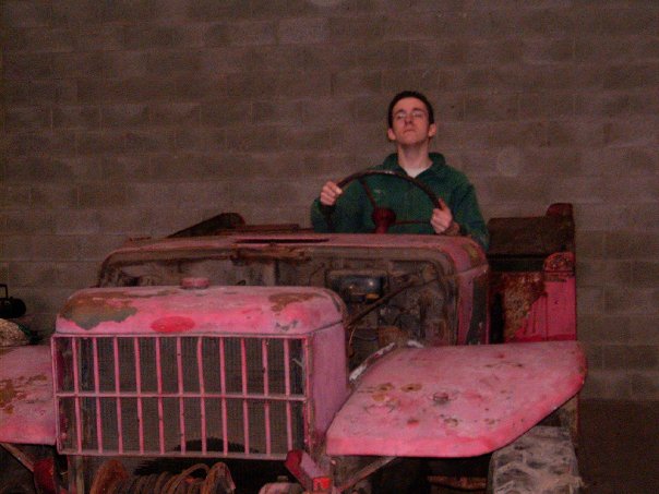

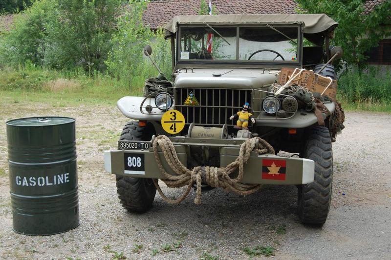

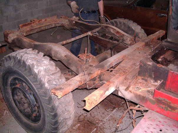

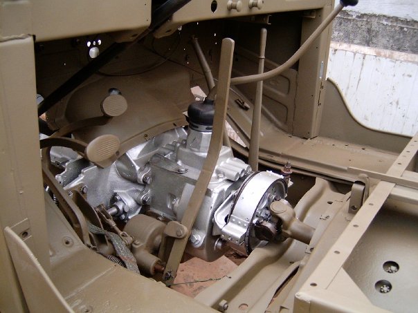

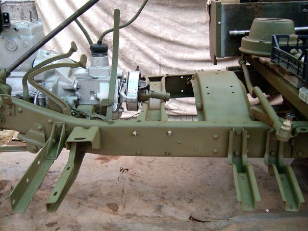

My dodge was restored some years ago by me and my father: years of restoration
