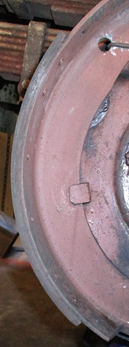

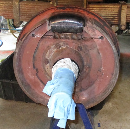

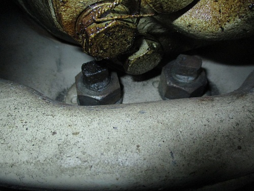

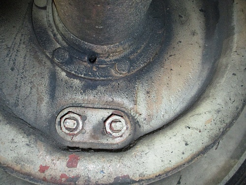

I don't think there is any significant differences in the pairs of backing plates. But David your comment made me check the position of all eight of the lower/major adjusters. The 4 rear ones were dots pointing toward each other. While the 4 front ones are at the 2 and 10 o:clock positions.
Name:	C60S Major Brake Adj LF_2426.jpg
ID:	108171Click image for larger version
Name:	C60S Major Brake Adj LR_2422.jpg

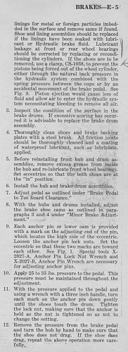

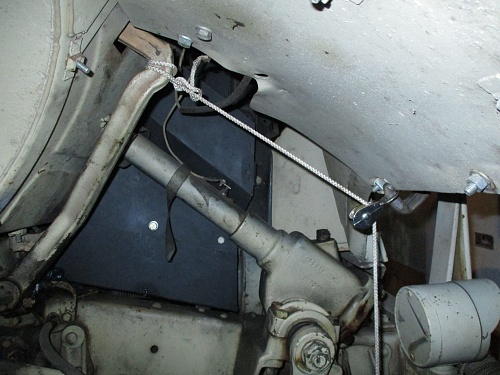

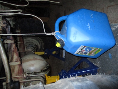

Second Rob's comments- "I would suggest you try a major adjustment again" Well I did a careful major adjustment per the manual:
10. Was getting a stead 30 lbs. pressure on the peddle.
Getting just 30lbs peddle pressure is a touchy thing, wish the manual explained the logic. You can see from the photo how this was done with a 30lbs with hanging pulley so as to put just that pressure on the peddle. This pressure seems to just take up the play in the wheel cylinders, without applying the brakes to drag. If you push down on the peddle just a little more and release the brakes apply and the wheels don't turn. So I went with just 30 lbs pressure.

11. With a short (3")wrench turned the two lower pins on each wheel just the smallest amount to just cause brake drag/sound. Repeated this on all the wheels carefully re-tightening the locking nuts. When the pressure was removed the wheels turned smoothly with no drag.
Robs last point is well taken "If the shoes are correct, and you are still finding the need to pump the pedal, then perhaps a good bleeding is in order. Fresh fluid in the system is a good thing, and a preventative maintenance item that is often overlooked." Because all CMPs have single brake systems I take preventative maintenance seriously. Any sign of leakage means full brake job. No leakage every 9-10 years replace all the rubber parts in the brake system, cups, boots, lines and of course flush the brake system. Last done on this truck 2015.

The 10 and 2 sound more correct. Both dots facing each other would be maximum retraction of the shoes. The shoes are likely wearing more at the top in that case.
Using the weight is interesting. Never seen that done before.
One more thing to consider is if there is a long lining shoe and a short lining shoe, and that they are in the correct positions according to the manual. That could lead to excessive wear on a shoe if it is in the wrong spot.

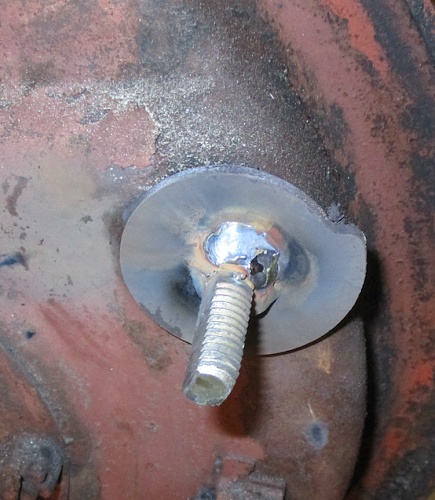

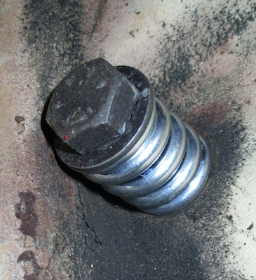

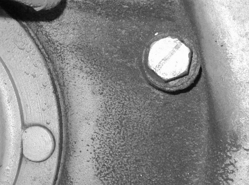

Here is the Right Rear B Adjuster as it was after adjustment
Name:	Screen Shot 2019-08-14 at 3.03.24 PM.jpg

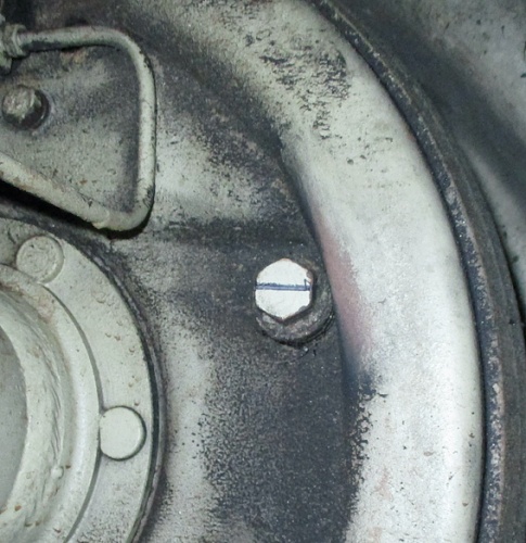

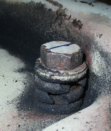

Here is the Right Rear B Adjuster 62 miles later as it is today.
None of the other A or B adjusters have moved, so I think the problem is clear one adjuster is no longer staying put but is rotating back from the force of the return spring. Obviously this is not a state of affairs that can be left uncorrected.
So the question is do what do I do and in what order.
Old 15-08-19, 04:11
Hi Phil, Can you change out the backing plate?
If not, is the offending adjuster working its way off the (adjuster) bolt.
The bolt is usually staked on the outside of the snail. Try compressing the snail back further onto the bolt, with something like a valve spring compressor. If it moves back, peen the bolt?
Old 15-08-19, 13:18
Posts: 2,323
Is it possible that the spring for the offending adjuster has either partially or fully cracked? This would cause loss of tension and also create blunt ends at the crack site instead of the ground flat ends of the spring. Possibly leading both to reduced tension and angled application of pressure. I've only seen one such cracked spring (that I recognized, maybe there were others) and it wasn't very obvious.
Just curious, do you notice any difference in force to rotate the two directions on that spring and compared to the other spring on the same wheel? You might have to take out the brake shoes to get enough rotation to notice and remove the effects of all parts other than the specific spring but you are probably getting close to doing that as you investigate.....
Old 15-08-19, 15:10
Posts: 7,623
Could it just be the wind up of the spring caused the adjuster to back off? Solution would be to sparingly put a little oil between the backing plate and spring, and the spring and the adjuster cam.
The original was, as Lynn says, likely peened at the cam. The peen could be ground off (in situ...no need to remove the backing plate), the "snail" removed, and a suitable spring put in place. A cut open socket or piece of tubing could be C clamped into place to hold the cam in place, and a spot of mig weld put on to secure the cam. The heat would have to be kept to a minimum in order to not destroy the tensility of the spring.
The proper way would be t have the backing plate on the bench, and the cam would be put in place with a staking tool. We had a C-clamp for that purpose with the Iltis series of vehicles.

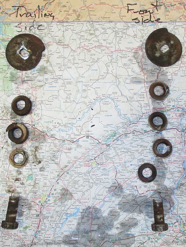

Well as I think everybody suspected the problem is in the tension spring on the adjusters. So I will be ordering some replacement springs.
Name:	Trailing Adjuster before.jpg
ID:	108682Click image for larger version
Name:	Trailing Adjuster.jpg

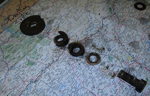

The rear most or trailing adjuster once the brake shoe was pulled back could be turned by hand with almost no resistance. Once the end was ground off so the adjuster could be remove revealed the spring was broken.

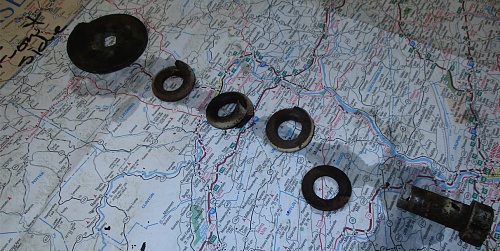

Name:	Leading Adjuster Before.jpg
ID:	108684Click image for larger version
Name:	Leading Adjuster.jpg
While the forward or leading adjuster required 25-30 ft.lbs of torque to turn, but on close examination it was discovered was broken into 3 segments.
Name:	Trailing Shoe Full.jpg
Take a look at the brake shoes, these are the original shoes mileage 24844.

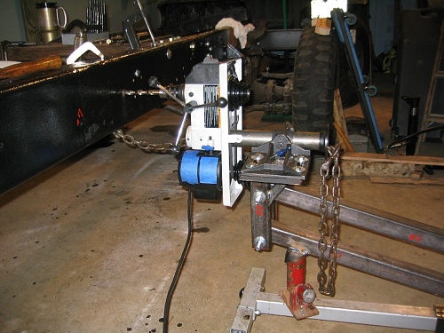

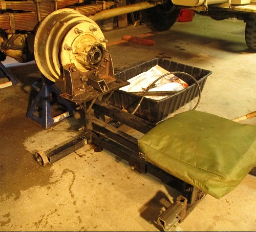

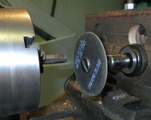

This is the unit I made up for pulling drum and hub assemblies. Some of you might recognize as the parallel lift platform I use for holding to drill press when drilling frame rails.
Name:	Hub Puller 2.jpg
ID:	108689 Click image for larger version

Default Ok finished replacing the Brake Adjustment Cam Tensioner Springs.
Found two sources of springs that looked like the right size and spring tension, more on that later.
First step was cutting new adjuster bolts with the squared of area for the cam plate to lock into.
ID:	108970 Click image for larger version
I cut the flats by chucking the bolts up in lath head, and cutting the flats with High Speed Grinder attached to the tool head. This could be done with a flat file and vice. Either way you want to get as tight a fit as possible.
The bolts are Grade 8 1/2 bolts, found that course thread work better than fine thread.
Once the bolts are notched down the correct length for the spring with a spring washer and cam plate you can check the torque required to turn the bolt head
Old 06-09-19, 23:46
Default Part 2 Replacing the Brake Adjustment Cam Tensioner Springs
One of the things discovered was that only one washer should be used as using more than one spring reduces the torque needed to turn the adjuster.
I tested two different types of spring from two different suppliers and found that they both yielded about the same results with the adjuster bolts when installed and the springs compressed short of being coil bound or totally tight of 10-15 Ft.LBs. of turning torque (initial torque to get the adjuster moving was around 20 Ft.LBs)

Now how to attach new bolt to cam plate while holding tension on the spring, I when simple put a nut on the bolt thread tighten it down, but with a spacer that would allow me to weld the bolt to the cam plate. Then with Mig welder turned up welded one side of the bolt and then the other.
ID:	108975 Click image for larger version
Then just cut off the excess to make clearance on the back side of the brake shoe and it is done.

The adjustments now take a nice steady force to turn so I expect that the backing off of the adjusters will be a thing of the past. Yes, I’m going to give both adjuster a horizontal witness line so that any movement will be easy to spot.
