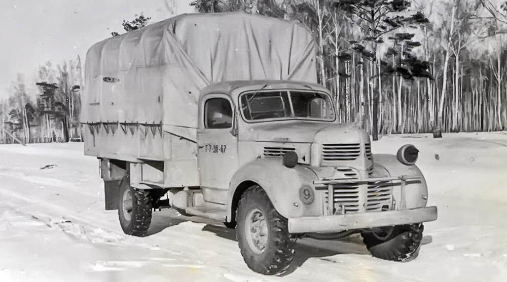

So far I've managed to dig out only one wartime picture with good quality of Canadian truck in Red army service and it is Dodge T110, enjoy:
https://i.postimg.cc/Z5FJnKNX/Canadi...-in-Russia.jpg
I also have some "indirect evidences", i.e. postwar pictures, if you're interested I'll post them too.
Cheers!

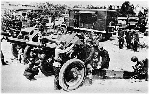

Ford F15A with Machinery "KL" for electric welding. Postwar photo.
Old 29-10-19, 23:36
Posts: 14,974
Hi Sergey,
Excellent photos, thanks for sharing!
