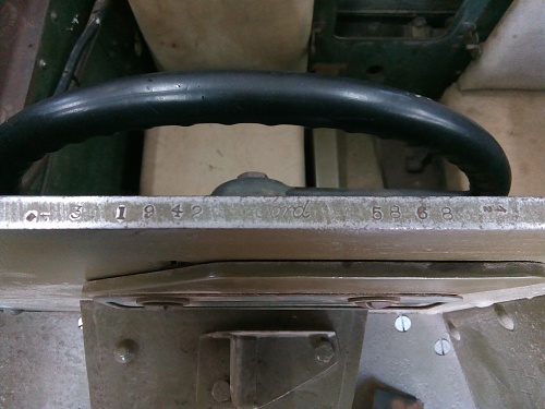

I've been under the impression that my Mar '42 Carrier was assigned the WD serial number T53664. See serial no below:

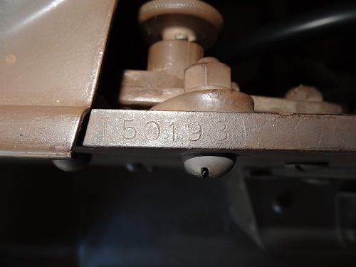

However, I've just found the following images of a museum Carrier (in SA I think), which seems to disprove the number I'd assumed for mine. As this one is over a year later than mine but with T50193.
Does anyone have a Carrier of serial number similar to mine (5868) that I can work the T number for mine out from?

Old 14-01-20, 02:10
Posts: 566
Hi Tom,
Surely that last photo showing the edge of the armour shows WD no. T50198 not 3 ?
Old 14-01-20, 02:26
Join Date: Jun 2011
Posts: 1,171
Hi Tom,
Yes, a numeral “8”.

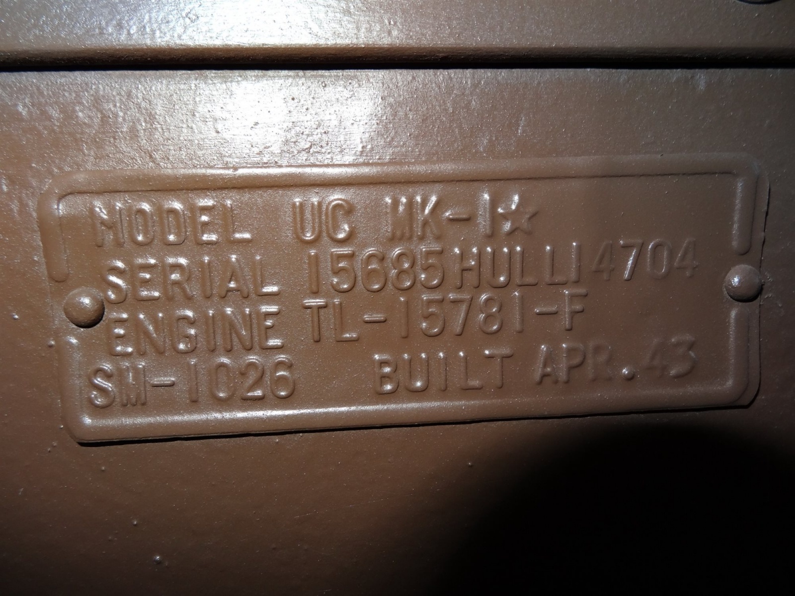

On the pressed serial plate, can someone show me by photograph where exactly that plate is located. I have never seen one of those plates in N.Z. and question that they were ever fitted to the carriers that came to N.Z. In saying that I have not seen a plate on the front guard either.
