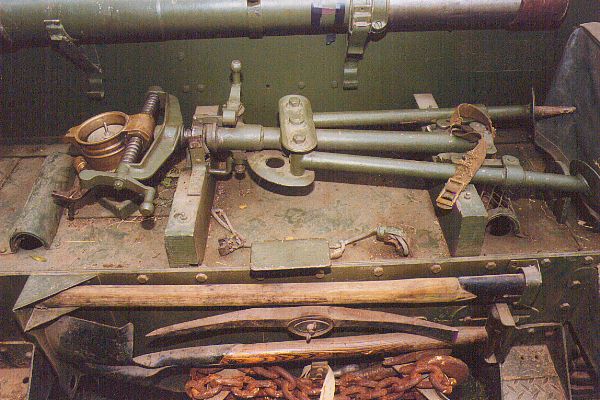

I thought i would start a thread on the rear mounting brackets to hold the 3" mortar tube, base plate on the rear and the stand.
I only have four original componets : two upright brackets for holding the wooden guide for the base plate and a later type metal quick release clip for releasing the tube, also top right hand side bracket for the starting handle.
If any one can add any pics or details that would be great, I have all the details from Nigel Watsons book.

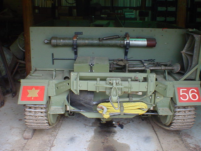

I have posted this pic before. They are British mortar carrier brackets that have been transferred to a nz army LP2.
The "nipple" or "tit" (can I say that) that the strap goes onto over the mortar tube is different from Brit. to Canadian.

thanks lynn, thats the sort of picture i can use to fabricate the tube holding brackets, many thanks, i want to replicate the quick release type fixing, because i have one already, and i guess the actual bracket you have pictured is the same contour. what is the s difference on the nipple?. strange they put it on a australian carrier.

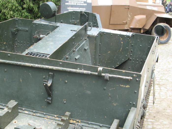

Hi, Found this mortar carrier pic, kevin wheatcroft collection, different type of straps featured here again.
If somone has additional pics of carrier mortar brackets, particulary for the mounting arrangement for the stand or any additional info please post.

The catch over the top of the barrell looks like it connects to a spring. See the photo you posted. (post #21)
