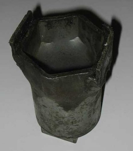

Top on my list is Axle Nut Sockets, I've seen to many axle nuts that you can tell were removed or installed with a chisel. Really good sockets the forged type are best but the stamped steel work fine also. Picture below is of the one I carry in my HUP it has been modified to handle both front and rear axles, yes they used two different sizes.

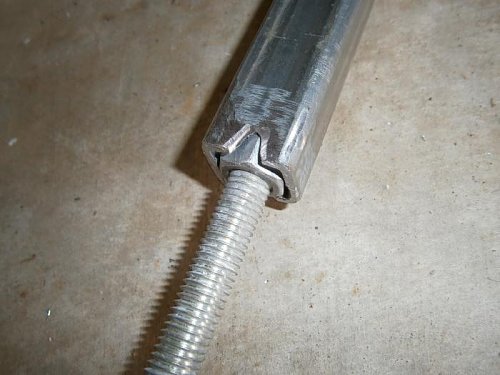

Here's something to start the ball rolling. This is a lifting frame I made a few years back to lift Ford sidevalve V8's with or without the transmission attached. It only requires the intake manifold to be removed. (See attached photos)
I borrowed the idea from the Ford CMP Maintenance Manual where they use a steel block placed inside the valve gallery to lift the engine and transmission as a unit.
Basically it is a piece of 75 mm x 50 mm RHS steel with two 75mm x 75mm x 5 mm steel angles welded to it. I drilled 8 holes in the angles to spread the load over a large area of the top of the block using the intake mainifold for their spacing, two holes front and back, four in the middle. Drilled a series of holes 55 mm apart and used a spare towing shackle to the crane via a smaller shackle. Depending on lifting a bare block, a full block, or one with the trans attached I select one of the four holes. By dumb luck the last hole at the rear was the perfect balance point for engine and trans attached. It is 115 mm from the end of the frame.
Works well in confined areas.

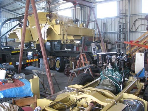

Got another restoration tool to add to the collection. I have never liked the common engine rotisserie because they generally just bolt up to one end of the engine which puts a lot of load on just 4 bolts going into the cast iron.
Particularly with the Chevy 6 that's a lot of length and a lot of weight. See picture of 261 engine on stand upside down.
Well when I started working with a Flat Head engine which while shorter, are heavier in this particular case, decided it was time to fully support both ends of the engine. The second photos shows what I came up with an adjustable front support, now the engine rotates very easily as it does not have the bending load on the single pipe swivel used in the standard commercial unit.
One afternoons work and now I wonder why didn't do it earlier. The only real time consuming part was making front adjustable in height because the commercial units actually have a 6-7 degree up angle in the swivel to compensate for the bending force when the engine is bolted on. So to take a 6 cylinder or a V8 you need to be able to raise/lower the front swivel so that it is line with the rear at the correct length.

I really get annoyed when I see pre 1949 Ford Flatheads on Ebay for sale being held only by the bellhousing in a modern engine holder. That's a real good way to turn a great engine into a boat mooring anchor.
I had this made up a few years back. Again, apologies to the Ford CMP Maintenance Manual for borrowing their ideas.
It worked well. The balance point was good so that you did not need a gorilla to rotate it.
Only trap if you fabricate one yourself is to offset the left pivot pipe about 1" further back from the front than the one on the right. This is because the left cylinder banks is about 1" further forward than the right bank. I have the exact amount written down somewhere but cannot seem to put my finger on it. No doubt that info is out there somewhere on the net.
This offset is noticeable where I bolted the brackets together for storage.
Cheers!

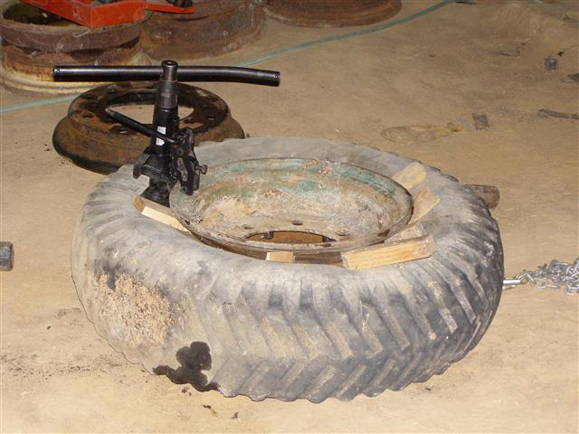

If you are changing your own tyres a good beed breaker is necessary.

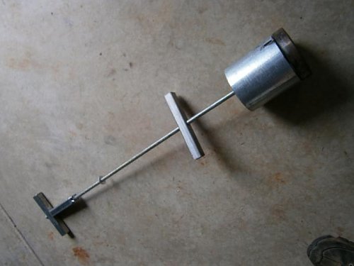

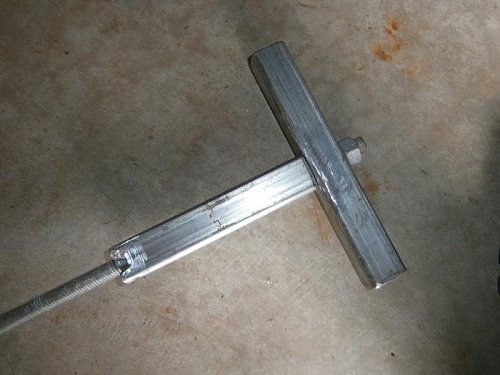

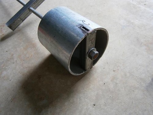

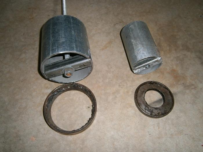

Default Bearing cup or seal installer.
Bearing cup installer.
ID:	54073 Click image for larger version
Adjust the threaded rod to the start length, then turn the handle to wind the cup or seal into place. I have made two sizes of drivers. These were used effectively on rear hub bearing cups and the seals in axle tubes. Thats why the extra long threaded rod.
These photos were taken before I welded all the pieces together.
ID:	54074 Click image for larger version
ID:	54075 Click image for larger version
Endless variations on the theme are possible. Not sure if I stole this idea from the manual or just had a vision

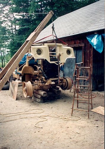

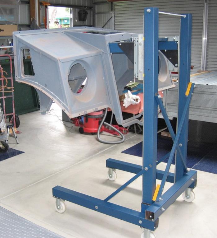

Thought people might find this of interest.
I know whenever I need an extra pair of hands nobody is around, or your mates have bad backs, are working, or have a golf match to go to, etc, etc.
Frankly too At 65, I am past heavy lifting anyway, and to eventually reinstall the cowl I came up with this solution to be able to do it by myself. I would really need two others plus myself to do it otherwise.
The base is made mainly of 75mm x 75mm RHS and has attached to the vertical posts horse jump keyhole channel. This allows the cowl (or another heavy object) to be placed at 50mm spacing. Any minor adjustment in height can be done with shims under the casters (or even letting a bit of air out of the front tyres).
The arms that attach to the cowl at the radiator support bracket holes are made of 25mm x 75mm RHS. This lifting frame is then positioned on the keyhole channel with 1/2" bolts and provisions are made to be able to slightly adjust the angle with the bolts for aligning the cowl to the cabin.
The steel horse jumps, which were made from the 75mm x 75mm RHS and keyhole channel, and the casters were donated to me so a couple of days work, and $30 worth of bolts was the total outlay.
I figured I would just need two people to lift it onto the right height keyholes and then the rest of it is a one man operation. I actually used my engine lifter to do it so it was a one man operation all the way.

Default Blitz cowl holding and positioning device
Hi Jacques
Like your nose assembly tool, your roll around stand looks like it would be very adaptable too the problem of positioning heavy and award parts.
As I've gotten older it is a matter of being craftier vs. stronger working on CMPs. So many of the lifting jobs in my shop are done with a jib crane which is adjustable in sever axis.
This weekend when I was looking for pictures of the side view of C60S to answer Hanno's question. Found lot of old pictures two of them show and alternative method of positioning the nose on a CMP another CMP.

Hi Jacques
Hi Phil,
Yes, I made it as much for holding and moving large bulky items to work on them as for positioning the cowling. The nose needs a few repairs: a few spot welds redone, a few dents removed and a few holes welded shut. I can actually mount it upside down on the rack at a nice comfortable height for working on it especially for welding.
I find if I dump something in the corner of the shed it just sits there.
I can also move it around now when space is at a premium.
Like your jib arrangement. Found the balance point of the cowling was close to the radiator support bracket holes on the 25mm x 75mm RHS so probably could have got by with just the engine crane to position it with fabricating a support bracket to attach to those holes.
Like you suggested it will come in handy for other things and I greatly improved my accuracy on the drill press building it. Can honestly say I did not have to elongate any holes to make the bolts fit!

A good gantry is also high in the needs list. Here I have the Canadian Scoutcar,Ford Lynx Mk.III* hull hanging high before fitting onto the chassis. Click image for larger version
Name:	Lynx Engine in and Hull on 105.jpg
Two chain pulls worked a treat off the gantry and another one on the No.7 crane set at the rear was all that was needed to maneuver the hull down onto the chassis.
A set of go-jacks enabled the chassis to be moved into position.
Can you see a Blitz there as well?
Regards Rick.
