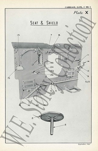

Default Q.F. 25-Pdr Howitzer Seat
Does this image from the Identification List for Ordnance, Q.F. 25-Pr., C Mk. II on Carriage, 25-Pr., C Mk. I also Carrier Dial Sight, C No. 18, Mk. I - 1943 help?

Old 26-01-21, 00:35
Well it does show that the seat overlaps the metal base, so it is likely pretty close to 12" diameter. It does not solve the unknown of the thickness.
I note the dozens of screws holding the wood to the base in your photos Ed. My manual does not specify the length nor even list them. Does yours?

Old 26-01-21, 04:44
Posts: 1,742
Unfortunately nothing on the screws or the seat thickness.

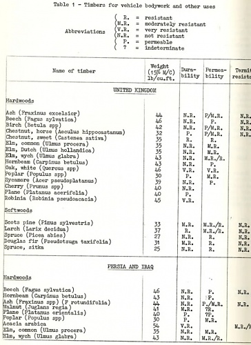

Old 26-01-21, 15:43
Posts: 14,974
Default Timber for old MV's
I was going to go with pine. I have 20 or 30 years left on this planet if I am lucky, and I have no plans of storing this gun outside. But if it is a hardwood, then I guess there is no choice. I think I have some ash planks out in the yard.
Many restorers think mostly hardwood was used, but many non-structural wooden parts were made from softwood. For a seat I reckon you would be good using pine.
See the link to HMVF below to make an informed decision:
For Canadian and British wooden bodies, indeed. Attached is a drawing for the Canadian 2H1 15-cwt body as fitted to CMP trucks. The construction of these bodies were based on the British design.
Note the thicknesses of the boards and the types of wood used in the construction of these bodies.
The British even published an Electrical and Mechanical Engineering Regulation (EMER) for wood specifying the various types of timber to use on vehicles - see HMVF forum: Timber for old MV's

Old 26-01-21, 23:23
Posts: 14,974
Default different places, different timber
I suspect different places, different timber. Pine was not common in Australia before WW2, whereas the local native species were available and abundant. The stocks on .303 rifles made in Australia used, from memory, any of three different native species rather than Walnut.
Aust production was most probably a native hardwood, while in Canada, other species like pine or spruce or maple were probably the most available?
Indeed local sources were used where possible. See the attached table from the EMER which specifies the "timbers for vehicle bodywork and other uses": the hard woods available in United Kingdom differed from those in Persia & Iraq, for example.
