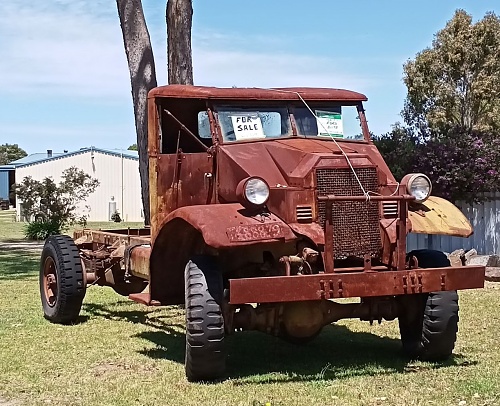

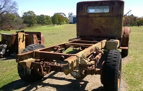

The F30S Cab 11's of 1940 often did have Chev axles. Mine has both front and rear Chev axles and I have seen other F30S Blitz's with either front or rear Chev and the other end Ford axles. This is mine which is for sale.

You could build a proper LRDG replica with this one.
Cheers Rick.
