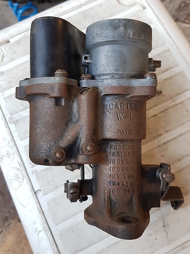

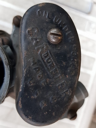

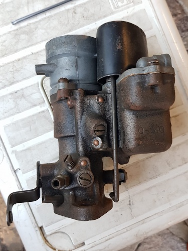

G’day!
I’m trying to help some friends restoring their C15A (radio)...
Could you please identify THIS carburetor they found on their vehicle?
Next step would be to have a overhaul kit for it!
Thank you!
Maurizio

It’s a Carter W1.
http://www.thecarburetorshop.com/CarterChevroletW1.htm
Hope this helps

Mmmhmmm.. yes, this was quite obvious from the script “Carter W-1” visible in the first image....
What I meant with “identification”were clues on what specific number of W-1 to check if this was possibly the correct first installation car by for that vehicle...
Thank you!
Maurizio

The following Carter carburetor numbers were used on the c15.
387S
W1-518S
W1-518SA
W1-589S
The last number is Carburetor second type having a Carter “dust proof” carburetor.
I also have a repair Kit listed as 1074-B
These numbers are from my c15 parts book 1945. I hope this helps you.
All of the W1 carburetors look the same , if you don’t have the tag number to verify that it is the original carburetor I wouldn’t be concerned.

Ok, i found indeed thus info somewhere in the forum... that’s why I asked a help in identifying THAT carburetor... I’m sure that - as usual with Carter - you have some number somewhere (on flanges?) that allow you to assign a virtual “tag” to the carburetor ... thus, Is this information available with somebody here that owns the correct item?
Thank you!
Maurizio

Scans of the data sheets for the Carter carburetors referenced in the C15A parts manual are attached. These data sheets are Canadian editions (see top, left corner). The information for the 387S, W1-518S and W1-518SA is all grouped on one sheet and appears to be unique to Canadian production based on the "Dept. of National Defence Special Vehicles only" terminology. The information for the W1-589S is on a separate sheet. The W1-589S is listed as being used on 216-270 CID engines which fits with this carburetor being listed in the parts listing for both the C15A and C60X (I didn't check all others).
The sheet for 387S, W1-518S and W1-518SA mentions number 329 being stamped into the face of the carburetor base that faces the intake manifold while the sheet for the W1-589S gives the stamped number as 541 (which matches the photo in the post to follow), which does match the carburetor I bought as NOS W1-589S from Brian Asbury.
Due to the different air cleaner mounting, I am certain that the originally shown carburetor is not a W1-589S.
The prices shown seem incredible now, under $20 for a complete, new carburetor (less $2.50 if you have one to exchange) and $1.07 for the gasket set. Imagine how little $20 would buy in the way of new carburetor parts today.....

thank you very much,.... very detailed.... I will now investigate this friends' carby with more informations!
thank you once again
maurizio
