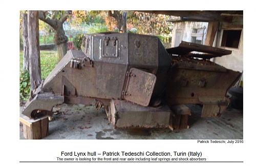

It looks like the Ford Lynx owned by Patrick Tedeschi in Italy. Thankfully the chassis is present, for springs and axles you may have to convert F15A 15-cwt 4x4 truck components. The track width of the Lynx is 63 inches versus 71 inch on the F15A, so you will have to shorten the axles.
Source: http://the.shadock.free.fr/Surviving...Scout_Cars.pdf
Attachment 122006

Its not the Lynx from Patrick Tedeschi. My Lynx was a couple of months ago placed on facebook in the Dingo group by a guy who found this in a wood.
Ah yes, the one from Erick Perino: https://www.facebook.com/groups/Mapl...1534251124928/
In the first photo you posted it looked like Patrick’s, hence my comment.

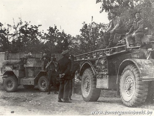

From a friend I recieved some photos of a Lynx MKI from the Manitoba Dragoons in september/oktober 1944 in Oostwinkel (Belgium).
Name:	phoca_thumb_l_120830 Oostwinkel - Canadese soldaten 2 - 1944_R.jpg
ID:	123216 Name:  phoca_thumb_l_Oostwinkel - Canadese soldaten 1944_R.jpg

Thanks for posting the period picture of the Lynx and Staghound of the 12th Manitoba Dragoons. My interest is the unofficial kit that the crews would carry on their vehicles. This crew looks as if they were in it for the long haul.
Peter

Another photo in Belgium (sept 44) from the Manitoba Dragoons taken near Brugges. Can you spot the 'upgrade'?

Another great period picture. All three are great examples of 'ad hoc' stowage that crews adopted in the field. Hard to tell in the picture but it does look as if the Observers/Gunners seat has been changed out ?

vice

Indeed the mounted a vice on the right fender. For wat purpose? maybe becouse its a MKI

Good eye!

good eye Crets !
