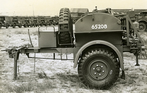

Old 17-09-21, 10:29
No pumps or filters, but I won't need them. They were pulled during it's post war service and the jerry can bracket built in it's place.
Nice find!
And interesting to see how it was altered in postwar use. The Dutch changed out the wheels on some of them to make them compatible to other postwar trailers, but left the filters in place - see Canadian 180-gal 20-cwt water trailer info
