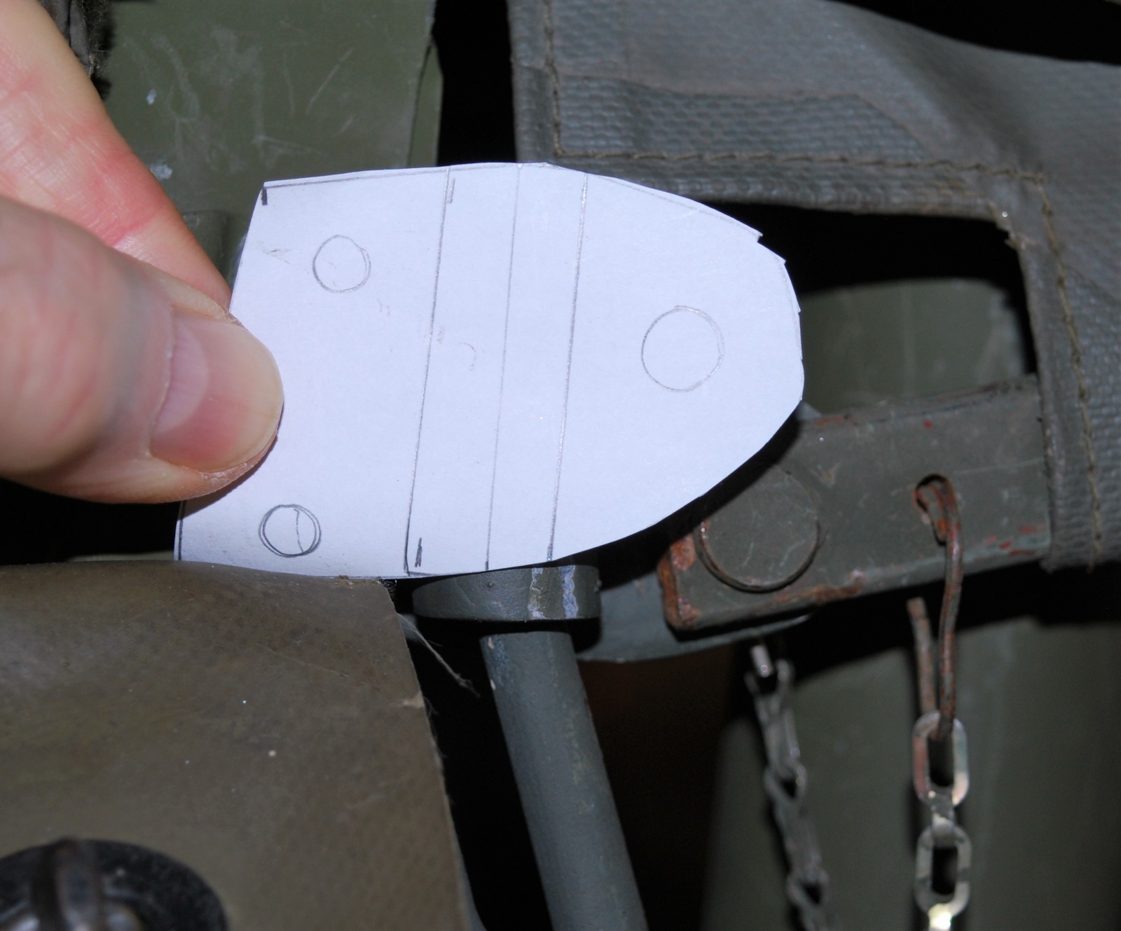

This would be what you are looking for. You will most likely have to make one yourself.
You can use either style of rods.
I do not want to take you away from this page...but there is a Canadian M151a2 specific FB group, which has this and other CDN mods posted in it.
The drawing originated from Rob Love.
Eric

I can tell you that the brackets I saw were nothing like that shown in the photo. They were quite crude, and held on with regular 1/4 bolts as opposed to the pretty machine screws shown. And no two seemed to be alike.

Thanks, everyone! That is the bracket I was looking for. Eric B thanks for the drawing😁
