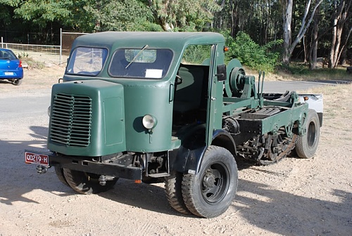

There are at least two Linn tractors in the Brisbane area. Note the electric start on the green one!
