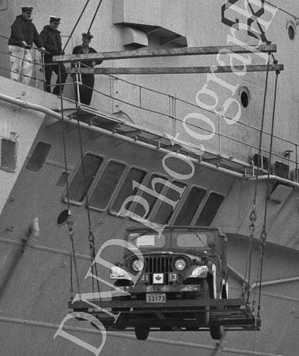

Posts: 1,742
Default M38a1cdn1 33173
So could M38A1CDN1 33173 being unloaded in Norway in this 1970 photograph have been used in Korea some 13 years earlier?
