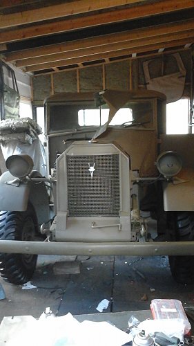

Old 06-03-13, 01:42
Posts: 7,623
Well, here is a bit of an update on the project. I had to remove one of the spring hangers, repair the missing portion of metal, and then re-rivet it to the frame. Tough job when you are working by yourself, but after having riveted upper armor on two different bren carriers, four rivets wasn't going to break me.
Anyway, the vehicle is now back on it's wheels, although I still have a problem with one of the links for the shock absorbers.
While working on it, I came across the serial number on the frame. The number is located between the steering box and the horn, on top of the left frame rail. This one is 1C5987*. Hopefully someone can later add the numbers from the similar trucks at the War museum and at Reynolds in Wetaskiwan. I believe there is also another on Vancouver Island or Victoria.
Anyway, here is a shot of the serial number and a shot of the truck as it sits. I still have to repair that steering box, and when it warms up the body will get a repaint to a more suitable color than the parade square green that it is currently in.
Old 06-03-13, 22:37
Walde Libera Walde Libera is offline
Location: Coquitlam, British Columbia, Canada
Posts: 95
Default Another proto type CMP in BC.......
Rob
FYI
Don Gordon owns the Vancouver Island one, he purchased it a few years ago from Gary Moonie. I took pics of this unit when Gary still owned it about 6 years ago; it was in pieces but in very good condition. Don is also a member of Western Command Club, we see him occassionally at events.
Walde

Hey Rob - Are you still working on the above vehicle? Don and I have the one that we bought pieces of from Gary Moonie virtually up and running. #IC-5984. Don did an amazing job of repairing and putting all the hand cut body parts back together, mostly with the original wing nuts rather than bolts, engine is fully rebuilt, (seems to run well with 100 yards on it - ha ha ), most body parts refurbished, all new brake lines, 6 volt wiring harness, switches and gauges rejuvenated by Sid Moorehouse here in Victoria, new rear wooden box made with all the original hardware. Don made a heavy duty jig and then used an anchor chain link (for the curve) to straighten out and then hand hammer both of the folded over and ruined rear fenders. Front bumper all redone to the correct curve by Pat Houle and his wonder press.
We are having problems with the clutch linkage and wondered if you had a picture of yours. The clutch will not dis-engage and the linkage bent!!!!! Cannot find another one.
Let us know how you are doing
Cheers Katrinka and Don
Picture of "Papa Bud"
Name:	Papa Bud Nov 16 2015 (38).jpg
Don & Katrinka Simpson
