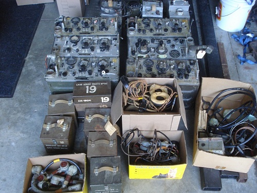

I had recently acquired a lot of misc wireless bits, mostly 19 set stuff.(see photo) I hope to put together a couple of sets for my own uses and will offer up the rest at the OMVA flea market later this month.
