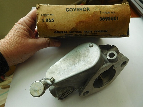

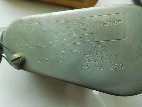

Default ebay listing - King Seeley governor for Chev 235
https://www.ebay.com/itm/26596530222...Bk9SR6rdx6XfYg
also attached the listing photos, including one that shows both the King Seeley part number V6 259 and the Chevrolet number 3693461. The buy it now" price is USD 99.00. The parts book page above lists this one as suiting 1950 235 engines (another model is listed for COE). I think that the same governor is probably a multi-year fit and that the parts book just cut off at 1950...
King Seely gov photo1.jpg   King Seely gov photo2.jpg   King Seely gov photo3.jpg   King Seely gov photo4.jpg   King Seely gov photo5.jpg

Old 04-10-23, 16:07
Posts: 14,975
Default Interesting thread!
"Governor" or "Govenor"?
Name:	King Seely gov photo5.jpg
ID:	136038 Click image for larger version
Name:	King Seely gov photo8.jpg
Attachment 136038 Attachment 136039
Hello Hanno,
You ask a very interesting question. When you find the definitive answer please post your findings here
Kind regards
Lionel
1935 REO Speed Wagon.

Default Spelling ?
Well, both versions of the Chevrolet Master Parts Catalog I checked use the spelling governor. Does that help or just add confusion?
The Chevrolet Catalogue of Major Assemblies CMA-01 seems consistent in using governor.
Note that the Canadian printed Catalogue of Major Assemblies uses the spelling catalogue and the USA printed Master Parts Catalog uses spelling catalog. The never-ending list of English language "localizations", or should that be "localisations"?
