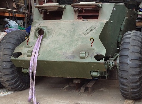

Labelled with question marks, they look like just some welded brackets - but what are they for and is there any date associated with their implementation? Only noticed them on a few restored vehicles.
Name:	staghound detail question.jpg
ID:	106266 Click image for larger version

Old 28-03-19, 21:08
Posts: 567
Quite possibly steps ?
Old 28-03-19, 21:44
Jack Geratic Jack Geratic is offline
Join Date: Nov 2011
Location: Ontario
Posts: 179
Dave, now that makes sense. Kind of like a foot hold to aid the crewmen when clambering up the front of the vehicle.

Old 29-03-19, 04:02
Join Date: Mar 2005
Location: Mississauga, Canada
Posts: 1,180
Default Brackets?
To hold a two piece cleaning rod for the gun?? Below the angles.
Peter S

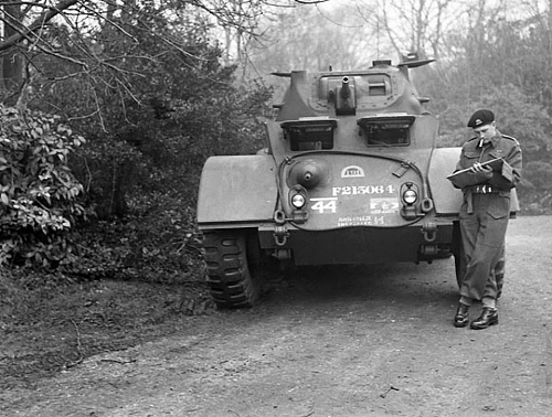

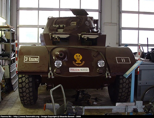

Peter, thanks for that, and I suppose it's a possibility for post war? Looking at a number of WW2 period photos, have yet to see a set of brackets in that location. Oh wait, you mean below the area in question? Pretty sure those are the base points for attaching headlights.
ID:	106268 Click image for larger version
regards,
Jack

Old 29-03-19, 12:45
Posts: 567
Those photos remind me of the obvious point that your brackets could only be steps if the tow rope was stowed elsewhere. If they are intended to be used with the tow rope they must be to lift it away from the hull which is a refinement that I doubt would have been regarded as important.
Come on Marco, we need your knowledge of Staghounds !
Old 29-03-19, 19:55
Posts: 3,170
Default Tow cable fittings
Is it reasonable to think the round bar stock could be a wear point for the shackle? The two upper fittings make sense, but would the resting shackle ends also bang against the armour and maybe someone thought there needed to be a protection point?
Old 02-04-19, 21:02
marco marco is offline
Marco Hogenkamp
Posts: 267
Default Steps and tow cable fittings
I also think the brackets are ment as steps for the turret crew.
The idea is to get in the turret as fast as possible and in this way it will certainly go faster than climbing the side of a fully stowed car.
Quite similar to entering a Sherman turret.
I have not seen these steps on WWII period Staghounds (yet).
The bar stock pointing outward from the headlight socket actually is a 1/2” UNF bolt with an “elongated” hexagon head 3/4” AF.
There is just enough space between the edge of this head and the hull to hold the 3/4” diameter towing cable.
Btw: am still looking for this (20 ft) cable.
I have seen 5/8” , 1” and 1-1/4” cables but never a 3/4”.
Marco

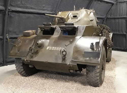

The fitting doesn't appear to be on this example on display in the For Freedom Museum in Belgium.
Name:	IMG-20190403-WA0021 - Copy.jpg
Old 04-04-19, 14:18
Member since 1998
Location: Western Australia
Posts: 471
Default bracket
Step for front mounting, used on Australian Staghounds.
Old 04-04-19, 16:58
Join Date: Nov 2011
Location: Ontario
Posts: 179
Thank you Wayne, Marco, and everyone who has responded.
So an Aussie invention, and that would explain it's presence on only some vehicles. Going by the set of photos found here, seems it can be dated to post war:
http://anzacsteel.hobbyvista.com/Arm...ghoundph_1.htm
regards,
Jack
