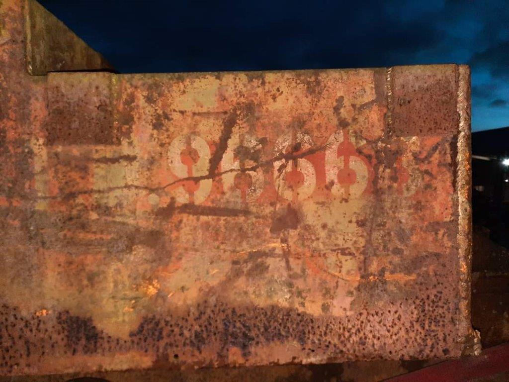

I bought a T16 carrier in South Germany march 2023. I never did a restoration like this before. A friend of mine is a draftsman and made blueprints of the parts I need because it's difficult to find the most of it. There are no dataplates on it, the only numbers visible is .. 2-43. In my opinion this carrier must have been made the 12th month of 1943, so a Mk1. When I cleaned the sprockets, i found the date of fabrication on these sprockets, 12-30-43. I think that the date of fabrication must be friday 12-31-1943.

Default census number TD96668
Plus some detail photos of the census number TD96668:
