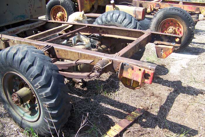

This is the only CMP I've seen where the large hole at the end of the frame is hidden behind the spring hangers.
Somebody pointed out that the spring hangers have been moved back to increase the wheelbase. I looked and the driveshaft has been lengthened too. This explains why the big holes are behind the hangers. This means the overloads weren't original.
hi cletrac
i noticed some major differences between your 11 and my 12...pic attached. what's with the helper springs?? i don't recall ever seeing them on the smaller trucks? cheers!! mike
