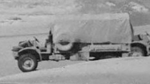

F30s? Or are these are 158” w.b. 3-ton trucks with roofless Cab 13 and the GS body moved forward with the spare wheel fitted to the side of the body?

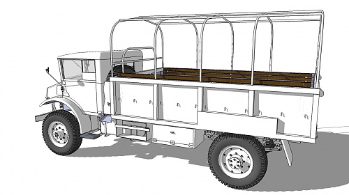

I don't like having to refer to scale models to depict a vehicle, but they do show the vehicle well: F30. Note that the model has 2 toolboxes under the front of the tray, the photo trucks only have 1 toolbox and a POL rack, making the rear wheel arch appear longer.

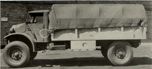

I think I see the side of the 3-ton GS body with the four sections and the wheel well cover covering the third and part of the fourth section. Compare with these pics:
Attachment 122975 Attachment 122973 Attachment 122974
Or do you see the Sand Channel moved rearward to make space to mount the spare wheel?

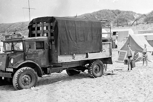

Seeing this F60L in Dutch civilian postwar service working on the beach reminded me of this thread.
It offers a good view of what the 3-ton GS body looks like sitting more forward after the spare wheel holder behind the cab was removed.
I am now convinced these are 158” w.b. 3-ton trucks with roofless Cab 11 or 12 and the GS body moved forward with the spare wheel fitted to the side of the body.

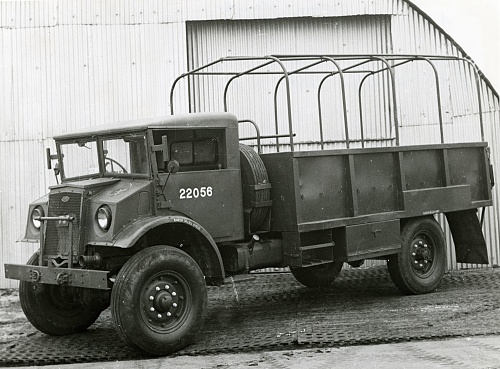

And I am now pretty sure the LRDG Heavy Section did not alter the body, but that these trucks were delivered as such:
ID:	132921 Click image for larger version

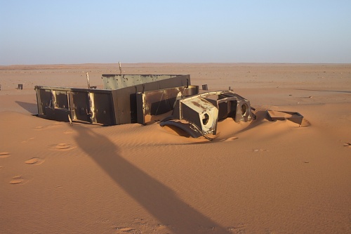

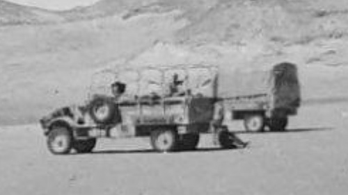

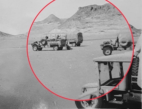

Two photos of a Cab 13 3-tonner with its GS body moved forward.
Notice the spare wheel holder dangling from the left hand side of the GS body.

Source:

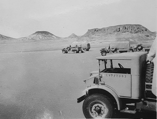

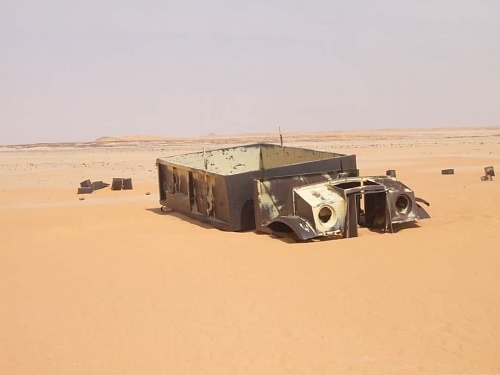

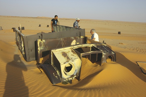

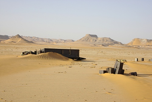

More photos of this 3-tonner. Note the spare wheel holder is being moved around every now and then.

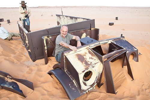

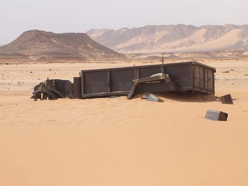

Fliegel Jezerniczky

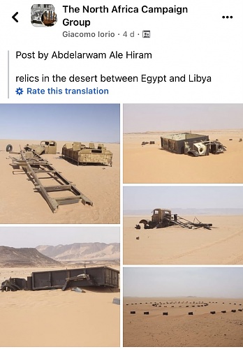

Any idea when the photo was taken ? When I last saw it in 2010, it was half-covered in sand, and as far as I know the area has been closed since 2012 (both to foreigners and locals).
No info on the unit, though most likely a SDF convoy truck (though it is a bit further north than the regular route).

Alan Hall, 2010:

Toby Savage, April 2012:
