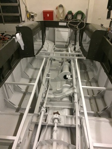

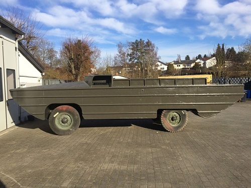

Niels Vegger noted this ad: https://milweb.net/webvert/a7619/106724
Is this for real? I have never seen any evidence of this being built during WW2.
1941 CMP Amphibious vehicle
CMP amphibious vehicle. Probably the last of its kind.
Canadian Millitary Pattern (CMP) Chevrolet 4x4 with 158.25 inch wheelbase.
Right-hand drive (!) As was common in Canada at the time.
The amphibious truck landed with the Canadians in Sicily in 1943.
The history of the vehicle is mostly known.
NO! - It is not a converted DUKW. chassis number; Frame; Axles; Transmission; Tire size and many more clearly show that it was a CMP watercraft from the start.
Most of the work has now been done.
The engine, both gearboxes and winch have already been completely overhauled.
It drives under its own power and would float.
Everything is there except for the original tank and dashboard.
Also windshield, rehling and hood. I am happy about your bid.
OFFERS
Andreas Burgard: 0049 1702 044263

I would like to see a lot more photos and some dimensions of this vehicle before passing judgement. One far shot is just not enough.
Also more information on how it moves in the water; prop and rudders or via the road wheels?
At the moment, the reality of this vehicle can range from complete fake at one end of the spectrum to it being a sole example or sole survivor of a limited piliot project built by Chevrolet Canada. To the latter possibility, GM Canada may have seen a need to have an alternate vehicle to the USA built DUKW, for any number of reasons during the war and developed something for trials. Trials may have been a failure, or a complete success, but anticipated need never materialized.
Much more documentation, details and photos of this vehicle are needed to fairly evaluate it however. Not something to drop the asking price on otherwise.

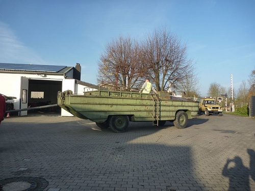

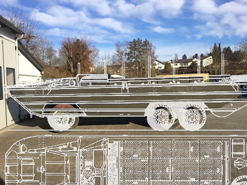

From what I know and what I read here I'd say this vehicle is at best a post war military conversion of a GMC DUKW, but much more likely a postwar civilian conversion using some CMP components.
If it is a conversion from a DUKW, it seems to be a pretty extensive one. It proved a little difficult to find decent DUKW drawings online, but even with a poor-resolution one overlaid on the photo, it’s clear that if this is a converted DUKW hull, a lot of cutting must have been involved:
Name:	DUKW-CMP hybrid.jpg
The shape of the front wheel well is different both at the front and rear, the rear wheel well is much smaller and squarer, not to mention further forward, the whole foredeck and the cowls alongside the cab are different, etc.

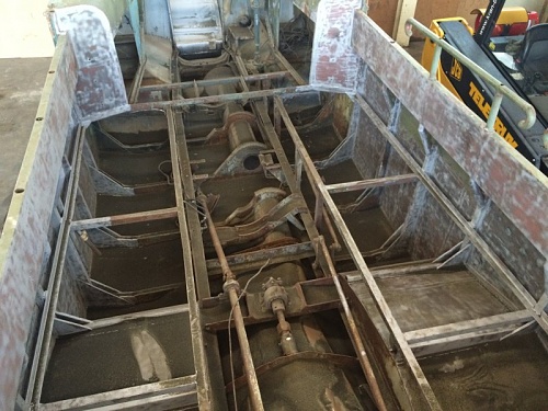

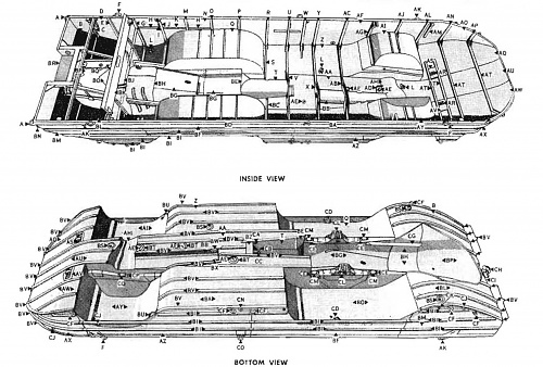

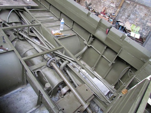

A detailed study of the hull structure may yield insights into whether the "Italian fire brigade duck" was converted from a DUKW hull or is some sort of copy.

I take it the first two photos are of the CMP conversion, since it has the steering wheel on the right-hand side, while the last photo is of a DUKW? If so, I’d say the CMP is a copy/“inspired by” rather than having been adapted from a DUKW. It looks like somebody had a DUKW at hand and thought, “We need another vehicle like that, let’s build something much like it on this CMP we also have.”
Old 15-04-24, 14:06
Posts: 565
I agree with Jakko. It is too professional a construction to be home made or a mock up or a scam and I see no evidence that it is a conversion of a DUKW - there are too many structural differences and no signs of modifaction to the wheel arches which are different to DUKW ones.
I think that the most likely explanation is that it is a post war Italian construction using then readily available new or nearly new CMP parts.
Old 15-04-24, 16:30
Posts: 14,934
Default To Duck or DUKW, that's the question
Yes,...
... plus I think they used some of the more intricate fittings like the propeller drive line and ducts to construct an amphibious vehicle for fire brigade/ emergency services.
The % of DUKW components is anyone's guess, this is very much a case of "Trigger's Broom". US-based operators of DUKWs have extensively rebuilt and modified DUKWs to a stage where they are a mere "dataplate restoration/ reconstruction" like many of the warbirds flying today
