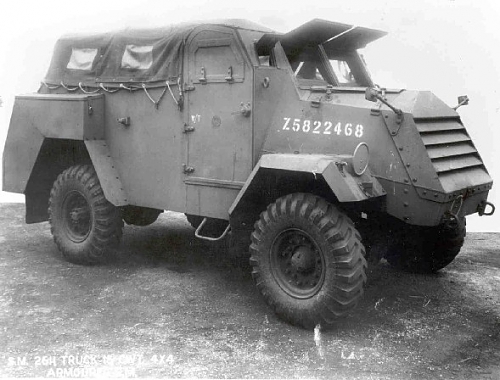

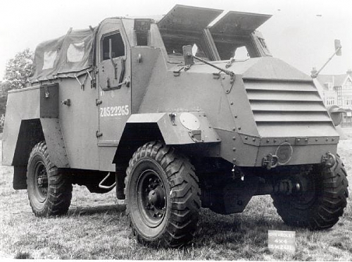

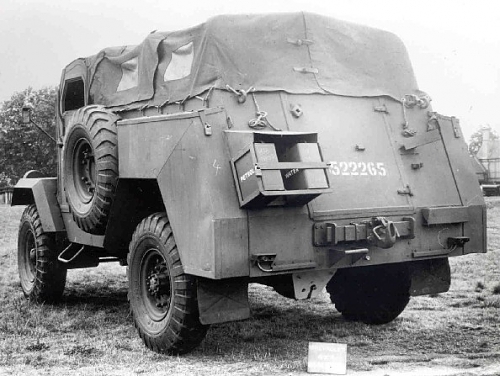

Attached are three Depot photographs of vehicles supplied under S/M2611.
The differing positions of the bridging plates is interesting, as is the two piece construction of the side panel on the rear box.
All pictures are from the Bovington Tank Museum colection.
For information e-mail the librarian.

Old 28-06-05, 20:00
David_Hayward (RIP)'s Avatar
former Resident Historian
Posts: 3,841
Default S/M 2611
Z 5822262 to 5822763 & Z 6173360 to 6173609 & Z 6192962 to 6193965 & Z 6263122 to 6263827
Those photos are part of the KIDBROOKE collection, usually found in the IWM. I must get copies!
Note the Z 85222265 must be a mis-stencilling...MOST of the KID IWM series of photos were taken on the same green and have the small blackboard or sign with the S/M contract number in chalk or painted on. The photo shows that it was to S/M 2611.

Old 28-06-05, 20:05
Posts: 14,934
Default Re: S/M 2611
Z 5822262 to 5822763.
The C15TA in Neil's first picture sports the WD no. Z8522265. If this one was supplied under S/M2611 also, this must be a case of "mis-stencilling" for sure? Or is this a WD no. from the unknown S/M 6507 range?
Old 05-07-05, 20:37
Posts: 3,841
Default Mystery
Note that the photo shows '522265' ...this is another mis-stencilling as it should have been Z 5822265!

Old 05-07-05, 21:13
Posts: 14,934
Default Re: Mystery
I have obtained some thumbnails of C15TA photos from the Tank Museum. Any experts out there who want to write an article please?
Can't claim I'm really an expert, but I've compiled some basic information: http://www.geocities.com/cmpvehicles/c15ta.html (it is apparently good enough to have been used in the compilation of a magazine article on the C15TA ).
Are you in need for copy for your CMP book series (in an effort to get them published? ) or is this for a magazine?

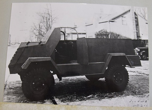

Old 03-09-24, 14:02
Posts: 14,934
Default Proposed Armoured Personnel Carrier
Originally Posted by Neil Ashley View Post
Regarding your request else where for pictures of prototype CMP's, they do have pictures of an early C15TA with forward facing seats.
Craig Moore found this photo captioned "Proposed Armoured Personnel Carrier" - clearly the C15TA in the making. Date and location are unknown.
Source: https://www.facebook.com/share/p/N39PE12FavmyELtR/
