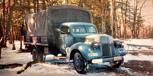

hello all. my name is leo and i'm from Connecticut in the USA i'm a new member to this form. have been following it for some time and has been a great source of info. i have a 1941 ford 3 ton duel wheel, long wheel base truck (158") that i'm in the process of restoring and converting to a marmon herington four wheel drive. the original idea was to represent a captured (US) truck in use by the ww2 german army. my original inspiration came from the book 'ford at war' by reinhard frank pg 19 captured ford in russia. i noticed several recent posts that are about captured fords so now is as good of a time as any. i have spent many hours researching captured fords and marmon conversions and while it maybe tough to say for sure weather this truck existed i do know that it could have been ordered from ford the way i'm building it. i'm going to try to post some pictures of my resto. the first couple are from when it was on the road (about 8 years ago) and will post my in progress picts next. i know this for a different forum but i also have a UC mark 2 that i'm also working on and will post that where it belongs. i'm very happy to finally get to be on this forum.
Name:	IMG_20130508_211729_392 new 41 d.jpg

Hi!
Respect to your restoration efforts and good luck in continuation and new projects!
As for prototype, frankly speaking, I can't imagine how 1941 trucks could appear in Axis service in visible numbers, especially with Marmon-Herrington conversion.
Most similar versions per my understanding are:
1. Dutch 1940 Fords with following changes
- it should be 1940 Front-ornament on the hood instead of 1941
- headlight stands from 1938/39 models (without lamp)
- additional wing lights similar to harley Knucklehead (optional)
- Nederlandsche-Ford emblem (optional)
Also i'd note that
- typical German gaparite pins are very rare on such trucks, however notek light was addded sometimes.
- Left mirror is untypical (acualy i never seen that)
2. US 1940 trucks shipped to Finland in large quantities
- Typically, cargo bed has low sides and another canvas
- Again, there are no left mirror.
- No gabarite pins
Also, such type of canister mounting is typical to German-originated Fords only.

thanks for the repiles. i figure the germans had captured at least 1 of everything at some point. i know i have seen a picture of what looked like a 1941 ford used by british forces in italy captioned "HQ truck in the mud near Rimini". as far as the 4 wheel set up it will be all original i have secured 2 marmon equiped trucks. one was a '41' with a single speed transfer case. and a '46' with a 2 speed and a compensating gear for the front axle. both were shortwheel base trucks 1.5 ton. i'm using the front axle from the '41' and the transfer case from the '46'. it's just a better case. my goal is to make it as close to 100% to 1941 ford as i can. i've already rebuilt the motor and gone thru the running gear, brakes, lines, etc. had to cut the chassie for the front drive shaft. mounted the crossmembers for the transfer case. i'm at the point that the rolling chassie is now a running and driving chassie. up next lot of pannel repair. i have loads of pictures.
IMG_20130815_185524_478 ford 41 b (1).jpg   IMG_20140317_214625_673 41 frame b.jpg   IMG_20140428_212236_883 41 ford (1) b.jpg   IMG_20140901_195253_777 (1) b.jpg   IMG_20150228_143639_122 (1) b.jpg

here's some from this past years Collings foundation. if you go to you tube and look for "battle for the air field 2016" you can see some footage of the truck in 'action'. if you do go note that i'm actually driving the Hetzer and one of my friends is driving the truck. lol. the first pict is of the truck and a PAK 184r (captured russian anti tank gun 45mm), parked next to the flak 36 88mm and last looking thru the driver periscope of the Hetzer at the 41. it's weird watching someone else drive your truck.
IMG_20161006_124350 bb.jpg   IMG_20161006_165207_078 b.jpg   IMG_20161009_152030_357 b.jpg
