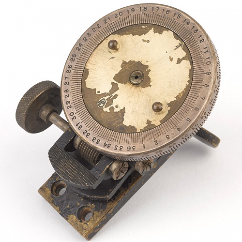

Question to Rick: Regarding the flap/bracket seen in your last photograph, mounted above the escape hatch, I am assuming is the mounting for a sun compass since it is adjustable for level. A sun compass is mentioned in the standard equipment for these vehicles but no mention is made of this bracket. Do you agree? Also, would the sun compass be the standard Cole compass or was it a North American type? The former would be more convenient to me as we have a Cole sun compass our family, (which was used extensively by our Father in explorations of the Egyptian and Libyan deserts).
Alastair
F60S
Lynx I MkIII*
Old 02-01-20, 12:41
Alistair, that is something I am not sure of. I have a Bagnold Sun Compass on my 1940 LRPG WB Chev. Here are photos of the Bagnold and Cole Sun Compasses for those who do not know what we are talking about..
Cole Sun Compass.
Bagnold Sun compass missing it's centre needle.

Instruction sheet for the Bagnold Compass.

The mount on a preserved Lynx.

My mount opened up a bit. My Lynx was on loan to a Museum for a while.

Hi Alastair, I have the same bracket on my Lynx and as far as I know it is for the compass. Although by the time my Lynx was built January 45 a sun compass might have lost its use!!! I had the same mount on the Fox as well but not on either Otter.

The Cole sun compass shown is very different to the one we have (dated 11 January 1940).
I am in the middle of making some Bagnold sun compasses and have been visiting the IWM at Duxford to study/measure/photograph the original. I will post a picture when they are completed.
