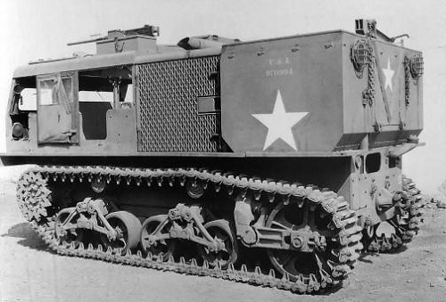

Actually, that is an M4 High Speed Tractor

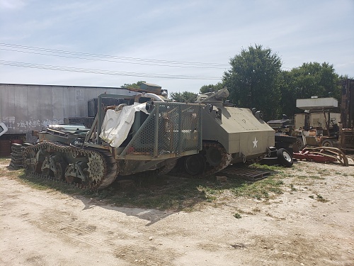

Here’s an M4 HST based carrier in Austin, Texas, USA

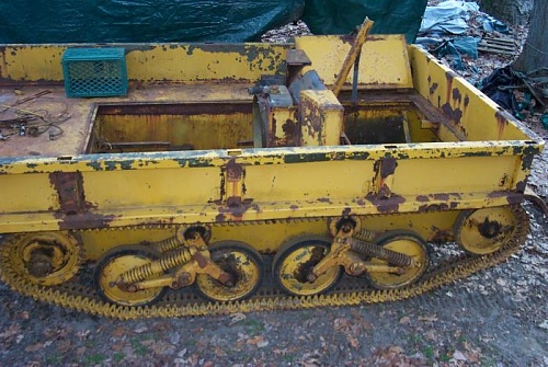

Southeastern Equipment Company (SECO) also converted surplus military tracked vehicles into tracked carrier for the mining and logging industry.
This included T16 Universal Carriers (see photo source), High Speed Tractors (it may be where the one now in Austin Texas came from). They also bought a batch of Sexton SPGs from Portugal, but it seems most of those were not converted and eventually sold to collectors.
Read a bit more about SECO here: http://www.mapleleafup.net/forums/sh...ad.php?t=13607
