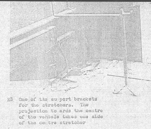

8th Recce MO track.
The roof bows on top are flat bar stock.

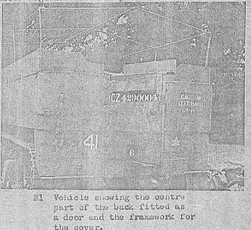

Notice that the bars for the stretchers don't extend all the way across so a third can be carried up the center to rest on the stands.

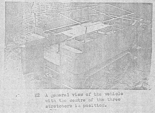

Center stretcher mounted.

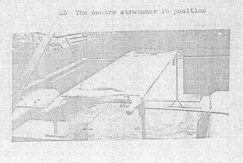

Last one. The fifth is virtually unviewable. I'll try again later.

Don
Many thanks for that interesting picture ! Great stuff.
My surprise is also that the rear HT corners are square (as per the Command HT pictures) - as I didn't realise the Canadians had the 'US' style HTs as well as the M5 or M9 series. Was this common ?
Pic looks like a de-gunned M14 AA version, by the cut-out in the rear door. The Poles however used them in the AA configuration too without change.

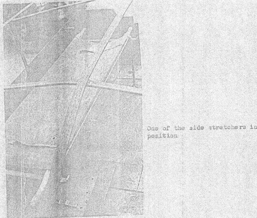

Got it.
Notice the rear door on the M14 (an LAD mod, fairly common on CW M14's to make them...useful) swings open to the left.
Interesting WD painting job too, with white letters on a black painted field.

Andrew:
Check out the rearmost corners, where the lower armour suite extends back past the folding side.
Most of the M14's in CW service had the guns taken out. They were pretty numerous (due to the generousity of the Yanks...who didn't want to use the homogenous armoured versions) and were next to useless in the AA role.
Lots of units used them, but the M5/M9 series were preferred as they had continuous armour from bottom to top and a rear door.
HTH
Don

Don - why was the door swapped to the other side ?

For some reason I had imagined a much more complicated rack system for the stretchers, upper and lower levels etc. I guess the kiss pricipal was used then too ! Now I have no excuse (except lack of funds) to daudle on my restoration.
