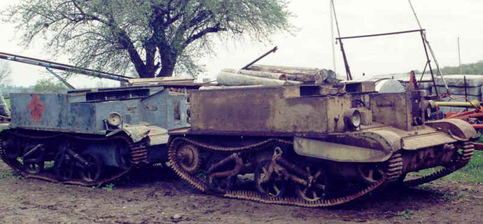

I got this picture out of Canadian Military Vehicles Profiles and wondered if anybody had any more pix or info on this variant It makes a neat looking machine but I wonder how useful it would have been.
Old 07-07-05, 21:06
I believe the number produced was about 10 times or more than that listed on the caption of the photo. I have seen remains of several around the prairie provinces.
Usefull? Probably about as useful as a 2 pdr (not very). The recoil must have been murder on the crew, and the muzzle blast would likely kill the poor driver.
Still, it looked pretty cool.

In regards to the photo Stewart Loy posted, i have a question about the engine cover . It is a rounded hood . I have a hood like that on a dismantled carrier i bought a number of years back. I was not sure if it was an original hood or was adapted to fit by previous owner . If any one knows about this type of hood i'd like to know more of it .
Thank you
Eric

Thanks Hanno, but i don't believe it is off of a Loyd Carrier. The Loyd Carrier hood is uniform width for full length. The hood i have is the same in previous picture. It is wider at one end tappering to other, it also has the inspection door on it as in the picture. Other carriers i have seen have a flat top for engine covers, that is why this picture caught my eye . Just curious about it if it is original or not . Hopefully someone knows of this type .
Thanks;
Eric
Old 08-07-05, 20:30
The rounded hood was probably made special for use with the 2 pdr. If you check the turret arrangement the gunner would need any extra room they could possibly make. The round corners would also keep him from hooking on the square corners.

A/T U.C.
cliff

Default A/T 2PDR.
Again.. along with part-transplant veh.
cliff

Default Donor vehicle
You know that your donor vehicle looks very good. YOu should consider selling it and using the money to buy the parts you need. Why cut up armour plate when sheet steel will work even easier and look identical . There are still bogie wheels around and lots of components really. A carrier with no armour at all on it sold for 5000us last year on Ebay. That kind of scratch could finish your gun carrier nicely.

Default A/T top engine cover
This is the top engine cover from my machine.It's approx.27"x23"x8"on highend of taper.
cliff
