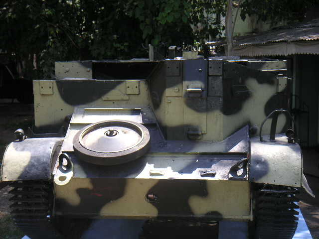

Default singapore carrier ?
The pictures of that carrier in Singapore I don't understand!!!
It has T16 wheels, The front is that of a T16 and yet it resembles a wasp carrier!!!
Please explain???
Make due with what you have I guess. Part of why I was wondering if the dish wheels might have actually been part of another allied or axis vehicle and were adopted at the end of the war for use on the T16.
The photos are also of two different vehicles that happen to have the same paint job. The T16 has a solid spare and the Wasp has a spoke spare and solid road wheels.
Swiss never had the T16 shown as it still has the brackets for the water kit out on the front edges where the turn signals were later added.
Nice parking pads though, don't you think? Keeps the tracks off the ground, has built in chaulks at each end and you can drive straight onto a trailer that is backed up to them.
