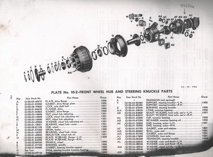

Posts: 267
Here is the first photo from the double-reduction front axle.
It was build specially by Chevrolet for the T17E1/E2.
It is really massive, many of the parts being to heavy to be handled without lifting equipment.
Wheel bearing diameter for example is 165 mm and the diameter of the brake drums is 16 inches.
Marco
Old 02-05-06, 23:54
marco marco is offline
Marco Hogenkamp
Posts: 267
This is the outer section from the front axle.
