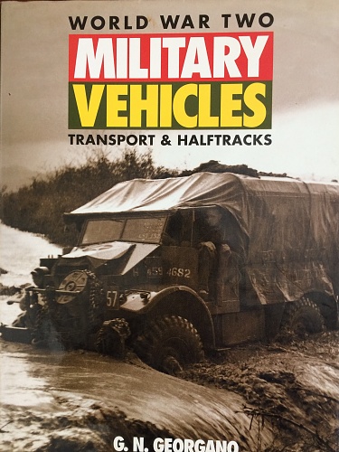

Guys,
I've always viewed that dealing with the weather, and logistics were almost as challenging as the enemy. I have always admired the dust jacket on this book by G.N. Georgano, perhaps someone can identify the make and model of CMP ?
Thanks, Peter

Originally Posted by Peter Duggan View Post
Guys,
Thanks, Peter
Attachment 105589
What a neat pic. Underneath all the muddy water is a Chev 12 cab with what looks like a 101" wheelbase. It's a British tractor because of the H census number. And what a number. It starts on the cowl, then continues on the radiator overflow can and finishes on...what? Is that a door? If so it's backwards as it should hinge on the rear if a regular 12 cab. The star on the bonnet would suggest NW Europe.

Is it A converted portee to tractor
Old 18-02-19, 02:25
It is indeed a Chev Portee (with 42 Cab, not 12 Cab), but I think it is not yet converted, it looks like it is still a 2Pdr Portee (H class was used in the original Portee configuration and also for a 17Pdr Tractor, but they switched to L class when converted to GS). The conversion to either 17Pdr Tractor or GS involved moving the fuel tanks from behind the cab back wall to alongside the chassis.
This truck on the book cover (although well equipped with other accessories like a signal wire cable reel and a vice on the front bumper), still has one of the hand winch crank handles on the side of the cab. Neither the 17Pdr Tractor or the GS conversions retained the hand winch on the rear body, which was used to load the 2Pdr up onto the rear deck. It looks like a embarkation stencil on the windscreen and an ETO air recognition roundel on the bonnet, so evidence of a Portee in Europe in 1944, and it still only has one single blackout headlamp!
Guys,
Thanks, Peter
Attachment 105589
Here the exact page from the book ...Its an Early Chevy CGT(Chevy Gun Tractor)..
Definately not a CGT, but indeed a portee or ex-portee as stated by others. Also, the truck waiting on the bank is a 3Ton truck with early GS body, not a 30cwt.
